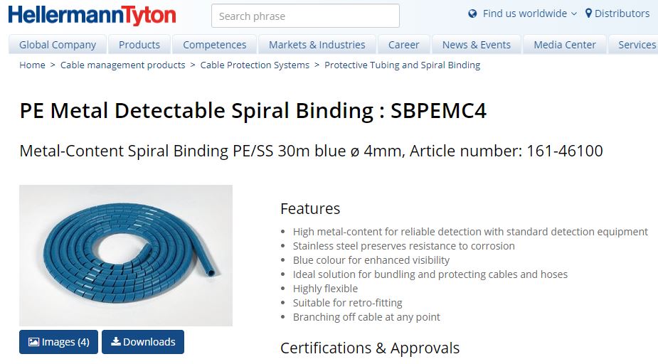

Good idea. Or stainless cable braid as used on vehicle fuel hoses. And I just found this:
:D
Metallised spiral wrap for use in the food industry. I've e-mailed the manufacturer to ask it it's actually conductive and hence anti-static.
Would be dead easy to install.
Good ideas in both cases.
