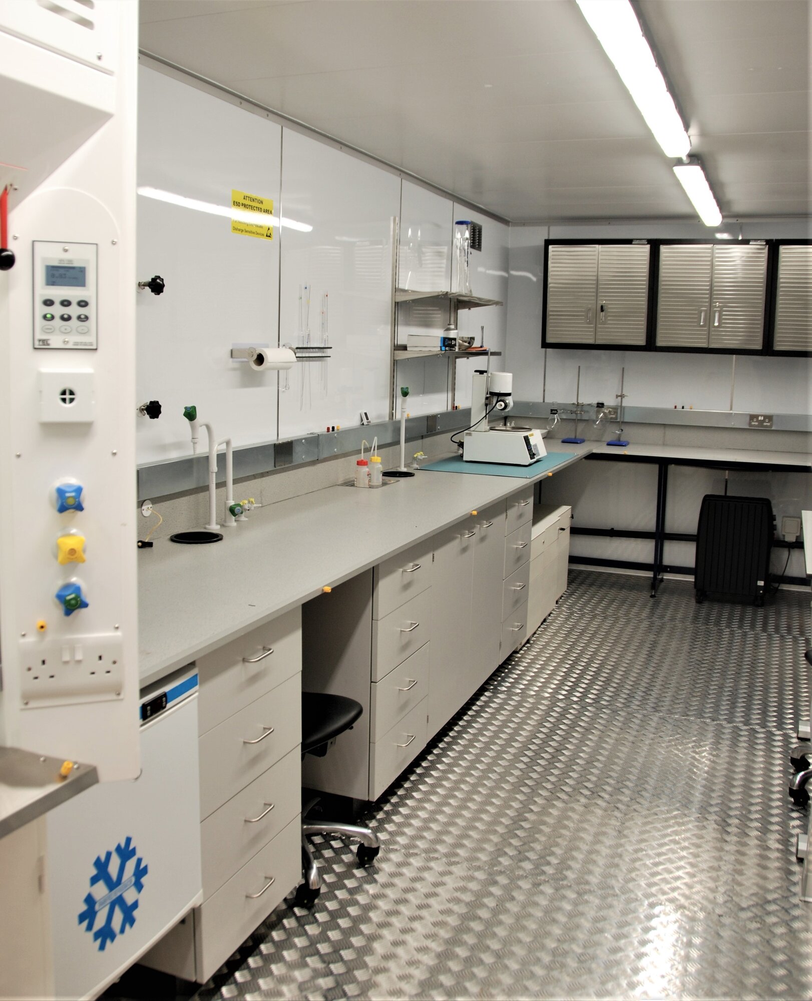

I’m converting a steel Portacabin-type box into a lab for static-sensitive equipment and materials.
If there are any ESD gurus on here, I’d appreciate any advice please!
I’ve ripped out all the vinyl, floored it with aluminium treadplate, clad the walls in painted aluminium sheets, and left the ceiling in the original painted steel.
Worktops will be in Trespa anti-static material, there’s a metal fume cupboard, and metal cupboards and shelving. Everything is bonded together, and earthed TT. Earth impedance is good.
I’m also intending to run a bonded metal (copper or maybe ali) strip all round the worktops, with little sockets for plugging in flying earth leads for loose equipment, wrist straps and so on. Conductive shoes will be worn, and no plastics or other insulators allowed in the building.
But this is all new to me: have I missed anything? The most dangerous errors are those you don’t know you’ve made!
And one specific question please:
Is it OK to use 10mm John Guest plastic plumbing pipe (Polybutylene), tucked away under the worktops? I need to run ring mains of mains water, Type 2 pure water, vacuum, and gas. There are no great flow velocities. It’s so much nicer to install, and easier to amend. Is a little bit of plastic pipe which will never be touched really a problem?

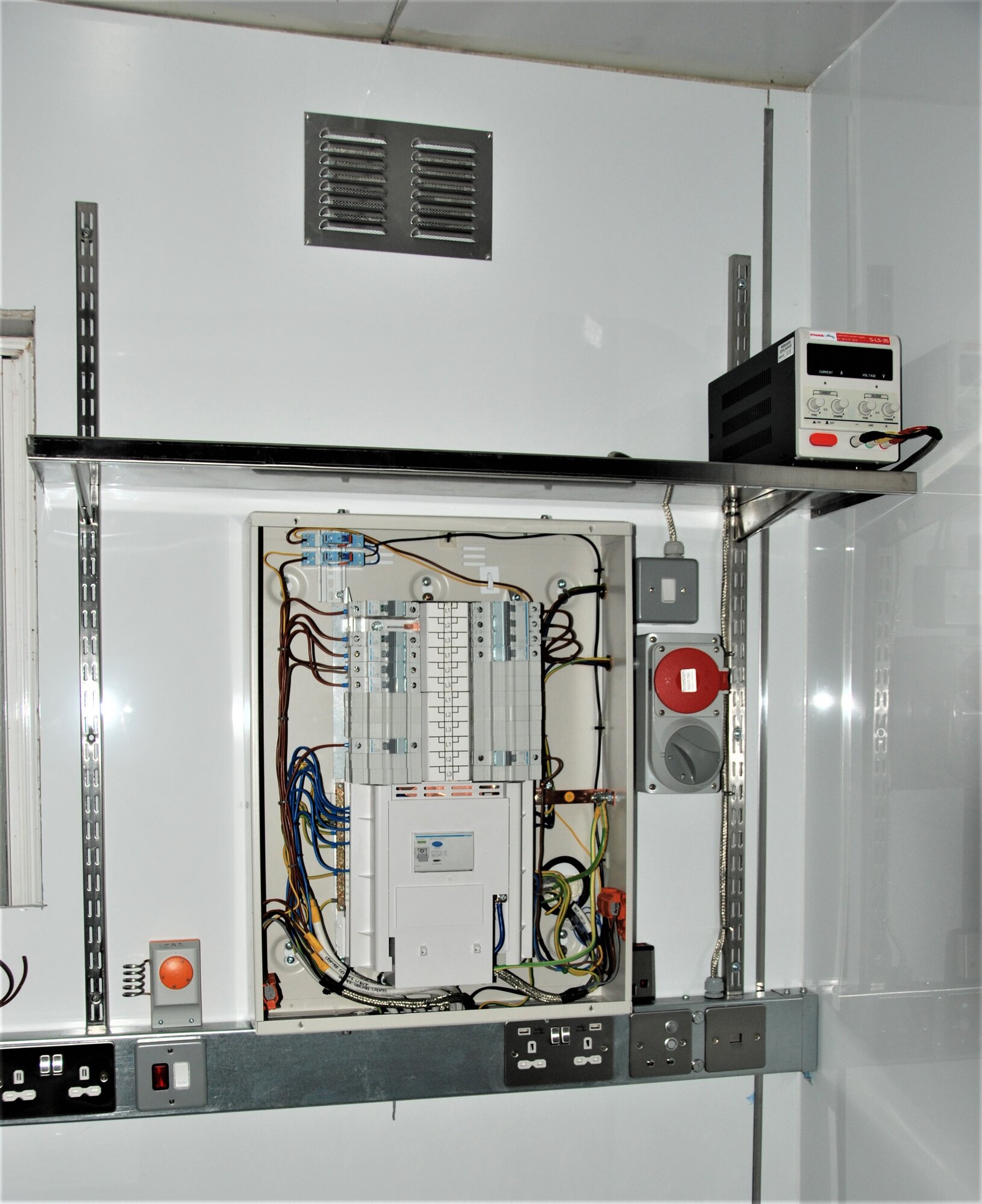

For anyone who might be interested in this thread in the future, I'll document my 'As Built' progress. I've finished most of the structural and plumbing stuff now so am installing the electrics.
I gave up all thoughts of dedicated dado power strip, and went with a run of 50 x 100 Salamandre galvanised trunking (From CEF, £7/m).
This meant cutting the lid manually, but avoids the multiple lid joints in the commercial systems. Inserting MK panel mounting plates, in what I think is the wrong place, ie behind the panel (lid), works well and will allow completely flush installation of accessories.
Also for wiring you would be looking at stuff in metal trunking ... or far simpler to handle using Flexishield cable ...
Thanks for the tip. I hadn't used Flexishield before and it's brilliant stuff. As is the recommended RS 262-0151 circular cable stripper. It makes T&E feel a bit Neanderthal :)
It sits nicely in the trunking, and stays where you put it.
As I can't use compartmented trunking as it would foul the accessories, I'm sleeving the ELV stuff: alarm, dc power supply, data, etc with braid, then tying it off at the top of the trunking. As this in non-standard, I'm not entirely sure if this satisfies current separation requirements but can't see why it's not OK electrically.
The picture below shows one dc power point, none of which will be close to any mains accessory.
The yellow socket is one of what will be multiple points at which to plug in (resistored) ESD wrist bands, or to ground items of portable lab apparatus.
To be continued :)

Also it shares the SWA attribute of being shielded in the electrical safety sense - so if punctured it will trip the MCB, etc, and disconnect safely. (OK in your case the resulting spark might not be good, but at least there is little electric shock risk).
Off hand I don't know if there are very specific requirements for separation, but certainly having an adequate air gap under any realistic cable movement, and the presence of the braid (and shield on the Flexishield cable) would satisfy me.

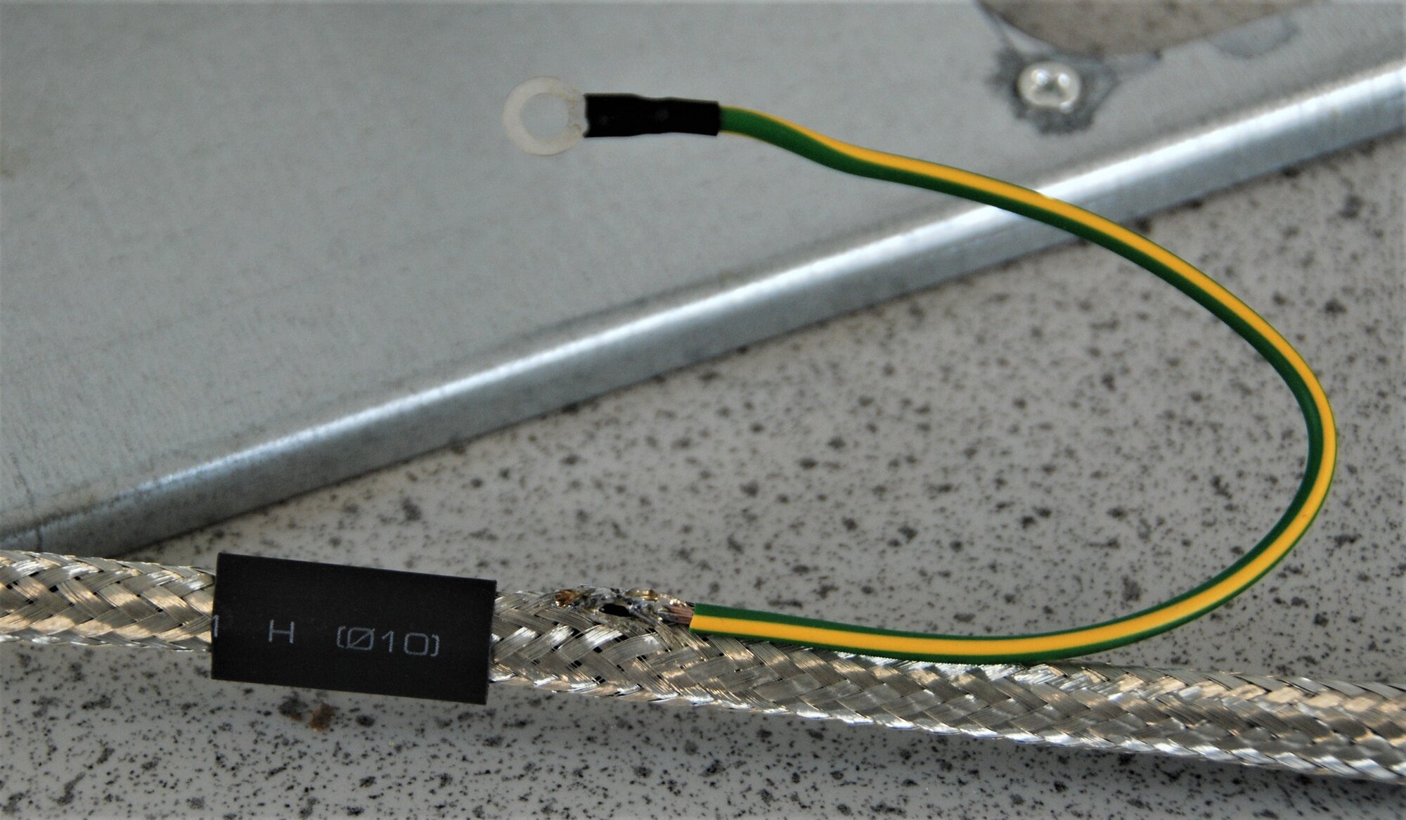

Just one point, how are you earthing the added braid for the DC and signal cables?
I guess they are all current-limited so low risk of any significant spark or even thin wire overheating if accidentally shorted out?
As per the above post, you need to look at the configuration of the braid and insulation of the ELV stuff in the areas around mains accessories where only basic insulation is present.
Consider a broken / faulty mains socket that exposes some live component to the interior of the trunking; unlikely but I've seen a line terminal break out of the back when the socket was hit at the front. If that component contacts the exposed braid, will it reliably witshtand the fault current in the way that the trunking would? Will it blow through and allow contact with the ELV circuit? I would rather have seen it insulated, perhaps by running plastic mini-trunking along the back of the steel trunking.
One aspect I mentioned earlier was the issue of fault energy and trying to keep it to a practical minimum by choice of MCB / backup-fuse / etc. That would also help a bit with the braid fault ratings.

This job is now done. Thanks for all the help and advice.
For anyone who was following, or may come across, this thread in the future here are the completion updates, 'as built.'
Someone asked how I earthed the braid. Solder and shrink fit:
Braid is used over any plastic plumbing to provide earth continuity to the ESD ground:

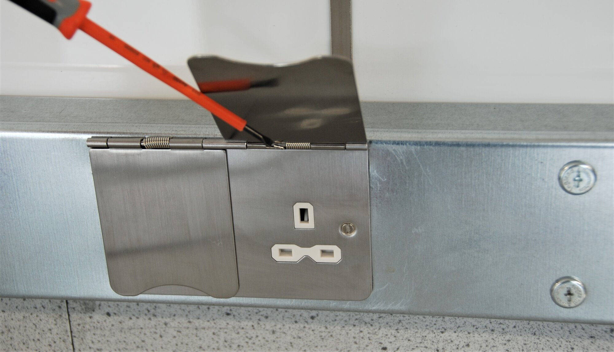

There were comments on the non-desirability of having 13A sockets exposed behind the work benches, which may hold exposed hazardous materials. I don't believe this is really a problem, but I used floor sockets to keep them covered up when not in actual use:
The DB installation is now finished. As this is potentially a portable building, it's fed from a 5 pin appliance inlet externally:
The incoming device provides 30mA protection to the whole installation.
The two small relays top left are for security lighting (common to the whole site) which activate internal and external lighting in case of alarm activation.
The PSU on the shelf provides ELV lab power.
The 'greenhouse' thermostat controls a single oil-filled radiator, and can be left at 4C for frost protection.
As far as possible all internal fittings are metallic, and bonded together and to earth.
The walls are clad in painted aluminium sheet from Aalco, with stainless steel jointing strips.
