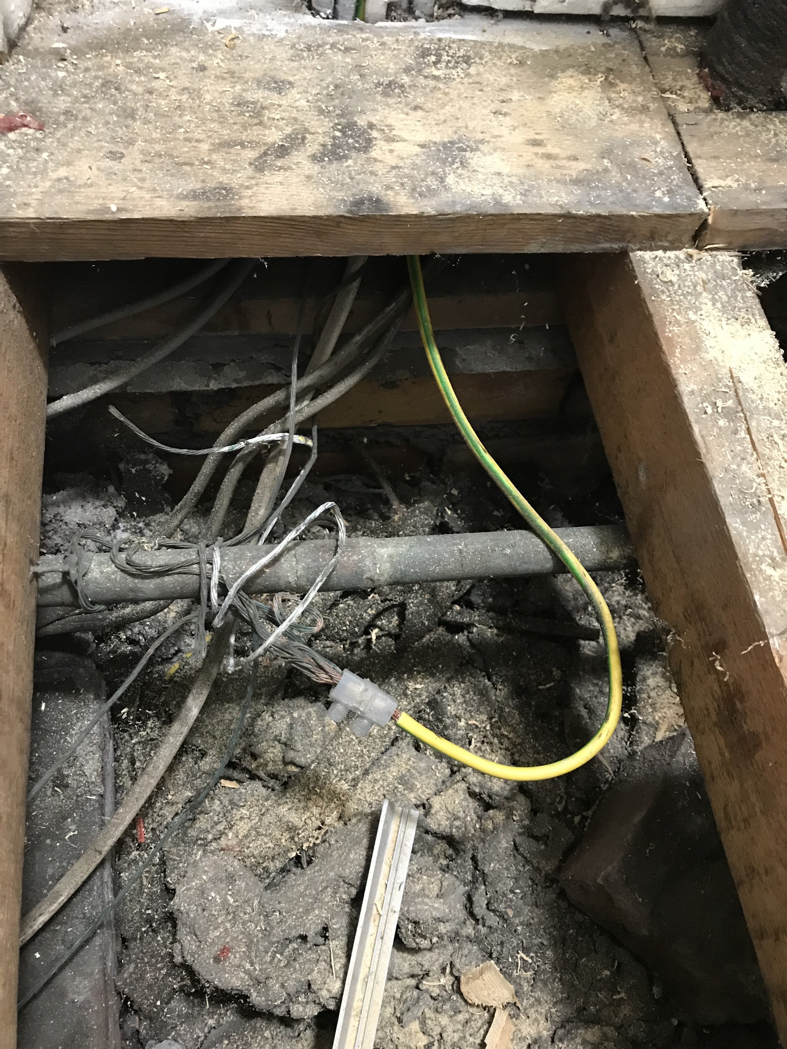

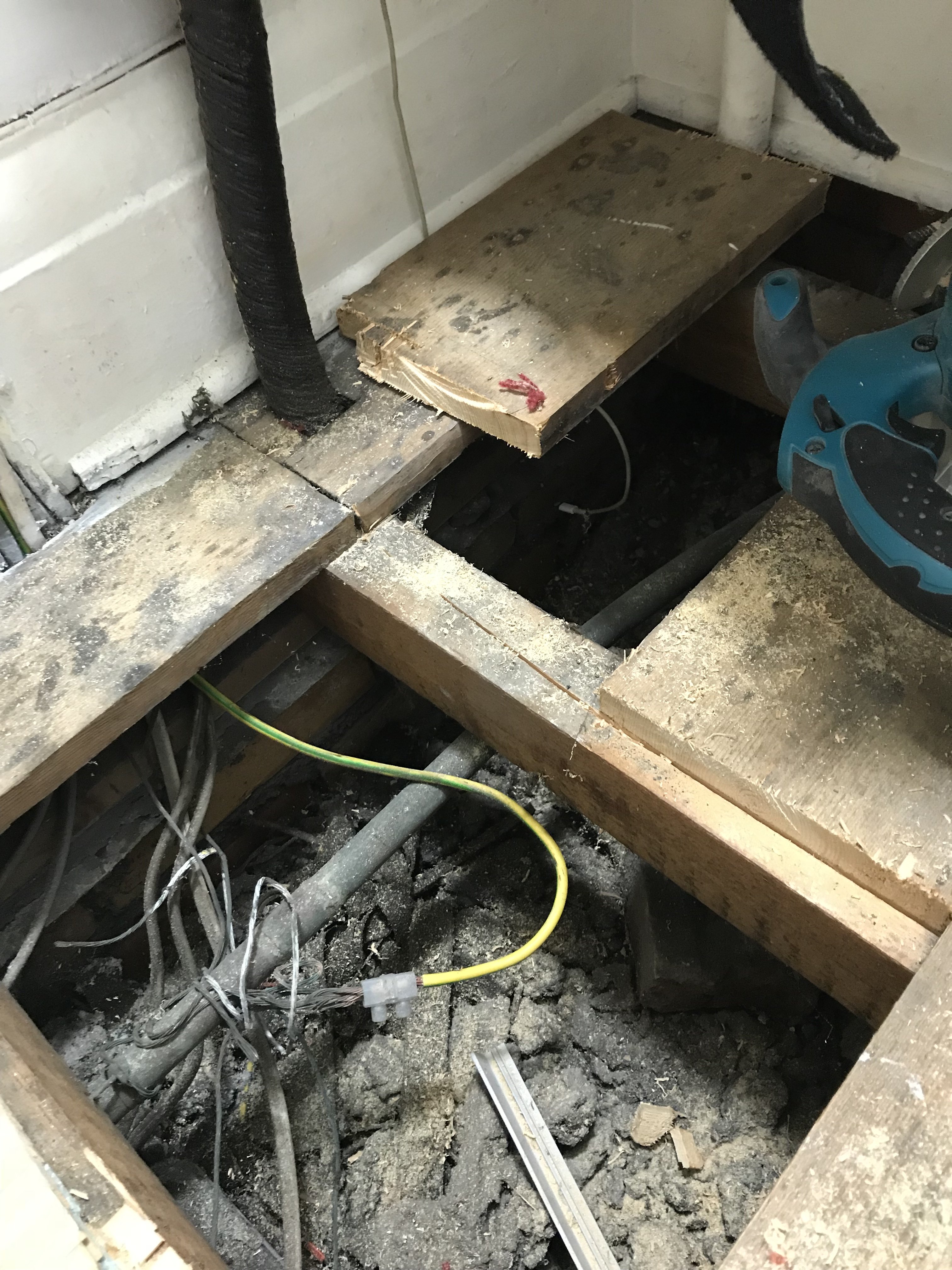

Evening all,
Just after some info on the photo attached. It’s a tn-s system with an Earth going to the cu met from under the floor boards. After lifting the boards I found the earth attached as so... I was expecting to see a clamp around the supply cable, not a choc block with legs of unknown origin attached. Can anyone enlighten me on what’s going on here? Thanks
That looks suspiciously like a copper pipe... gas or water maybe, so my guess from afar would be that's bonding not the main earth.
There do seem to be a number of bare conductors floating about under the floor boards.
At first glance, I thought split concentric.
I think you need to find out just how many conductors are there, and where they come from.
