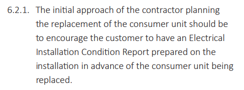

I thought it was only a recommendation to carry out an EICR prior to a board change - see 6.2.1 from Best Practice Guide No1. - It goes on to say (6.2.2) 'what if' the customer refuses a prior EICR.........
It may be that an EICR is undertaken prior to in any case (eg for the PRS scheme) and be 'unsatisfactory'. Replacing the CU and certifying as part of any remedials would then deem the installation 'satisfactory'!
Which is why I asked has he actually done an EICR. If not then you can't provide a Report.

OP, in your case, it is definitely both. The initial EICR and the EIC for replacement CU and any upgrades.
