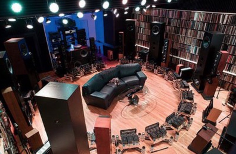

How serious are you about you AV stuff as it might be cheaper to sell the house and build your own?
Wow that's some setup - I don't even know what the things in a circle on the floor are!?
Mrs Deuce would not accept anything like that. She's a hard, angry woman ;)
In the next house I'm totally having a dedicated cinema room though :)

That set-up cost $6M
Mate has a cinema room, 5M screen sofa's etc etc full cinema surround sound etc etc I think he has 225 speakers around the house, the sound is amazing in the cinema room though.
