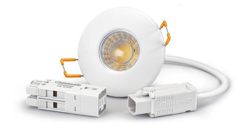

I've fitted a few of the units linked below now. 70mm cutout (easy for you to enlarge existing holes), smallish lens (although not quite as small as you've been tasked with finding), fire rated, IP65, 5 year warranty, choice of bezel finish.
Colour temp is also selectable from under bezel. I don't imagine many people change colour temp once lights are fitted, but like the idea of not needing to pull it out of the ceiling if one should happen to be set incorrectly.
Edit: Almost forgot the best bit - prewired with quickwire T-connector, so 60 seconds to 2nd fix as long as wired in T&E.

The T-connector does a bit more than save time on 2nd fix. Cables can be terminated in their half, which allows power to the circuit without downlights being in place. It also means quick disconnect if you wanted to remove for painting or replacement. It was the Quickwire connectors which first drew me to these lights, but purchases (both initial and subsequent) have been made on the basis of *perceived quality.
I state 'perceived' as it has only been 18 months or so since I first fitted them, but they appear to be well made and are backed by a decent warranty.
