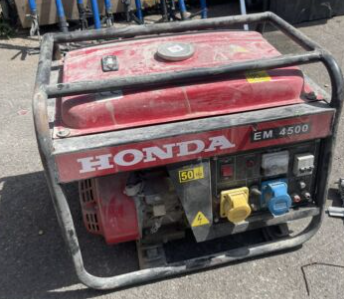

I have just bought a generator for back up power. Honda EM4500 and has both 110v and 230v outputs.

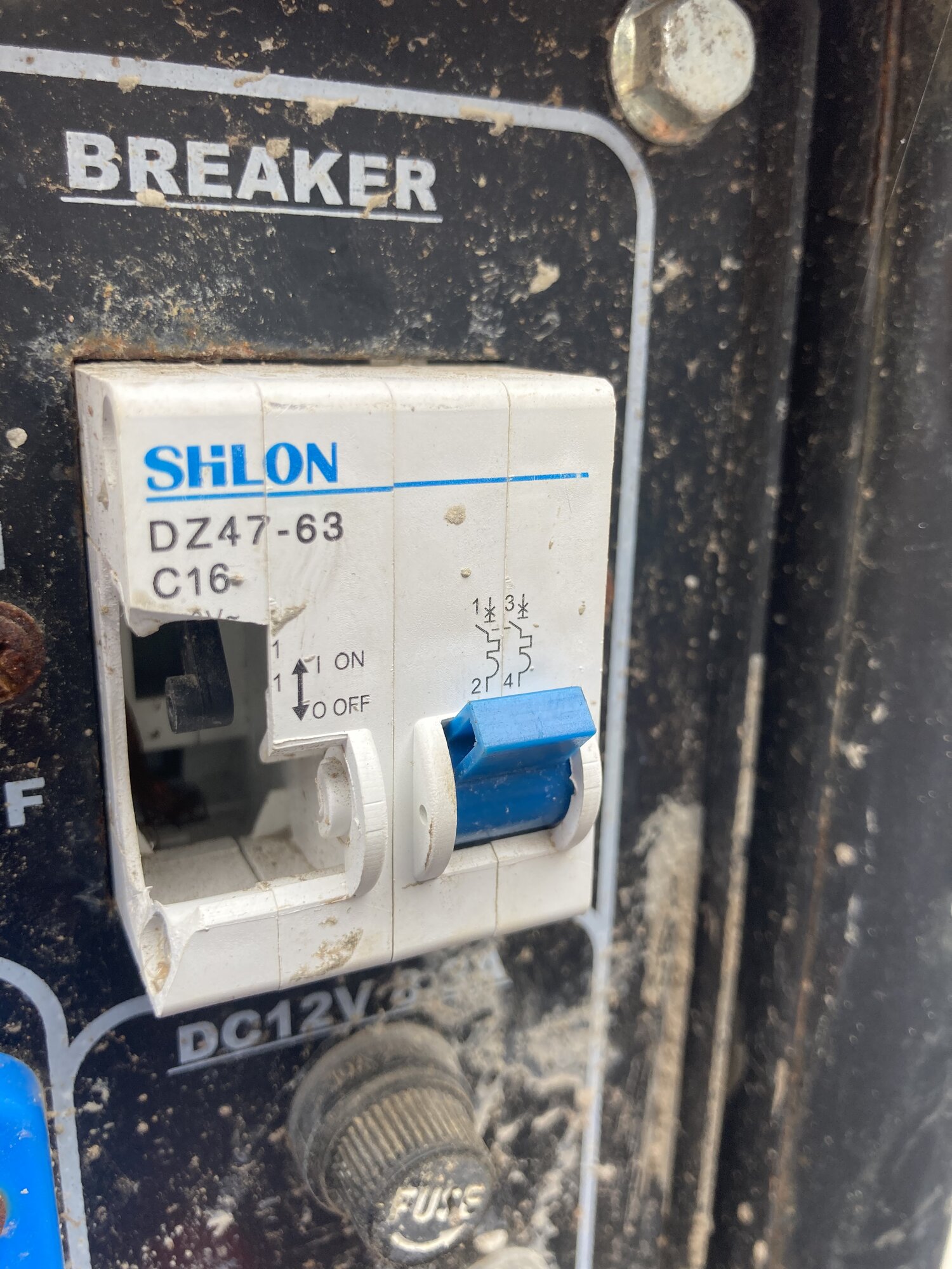

The circuit breaker for the 230v is snapped and when looking up the part number 38220-ZR7-F21 19a breaker it’s coming up between 60-90£ And mainly shipped from overseas. Can anyone recommend an alternative that I can buy locally and doesn’t cost more than buying a whole new generator instead.

Great thanks, I have just ordered. The manufacturer was trying to convince me I had to get the exact same part which I why I wanted to ask the experts 1st.
That said..... Looking at the damaged case it seems more likely it was an RCBO.
The schematic indicates an mcb but the link bar and one of the toggles is missing.
Agreed - was what I first looked at. I just wondered by the very 'square' damage above the missing toggle and the internal lever beneath if a test button had once been there and an additional diagram missing.
