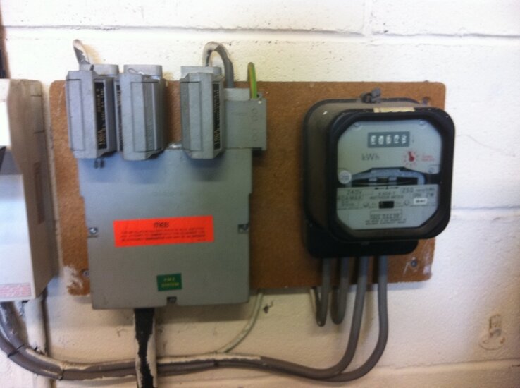

Hi i have a job at a garage to install a new three phase board as they are having ramps ect. There is a three phase supply but currently they have a single phase board on a single phase meter. The question is can i change the meter to a three phase or do the supply people have to.
Cheers
Dno's equipment, DNO's job!! however thats not three phase! that looks a lot like TNC-S 2-phase and N to me
it is 3-phase mate sorry it does look like the tail comes from the thirs main switch but it dosnt
yer i thought so just wanted to check it was just that all the clips had been cut off from being changed before
That looks suspiciously like a fused N to me, although im sure it isnt and has a link in it instead.
Im with Jason there anyways Contact the DNO and they will advise you as to procedure and any cost expect a few quid
It does look like that at a first glance, but if you look a bit closer you can see the neutral is connected next to that cutout fuse in the enclosed neutral/earth block and disappears behind it... The DNO cables are routed behind the mounting board, but looks as if entering that cut out fuse!! ...lol!!

Fused neutral indeed,the suppliers dont have them do they :rolleyes:
Correct!!!
It was that that originally got me it's a real illusion
