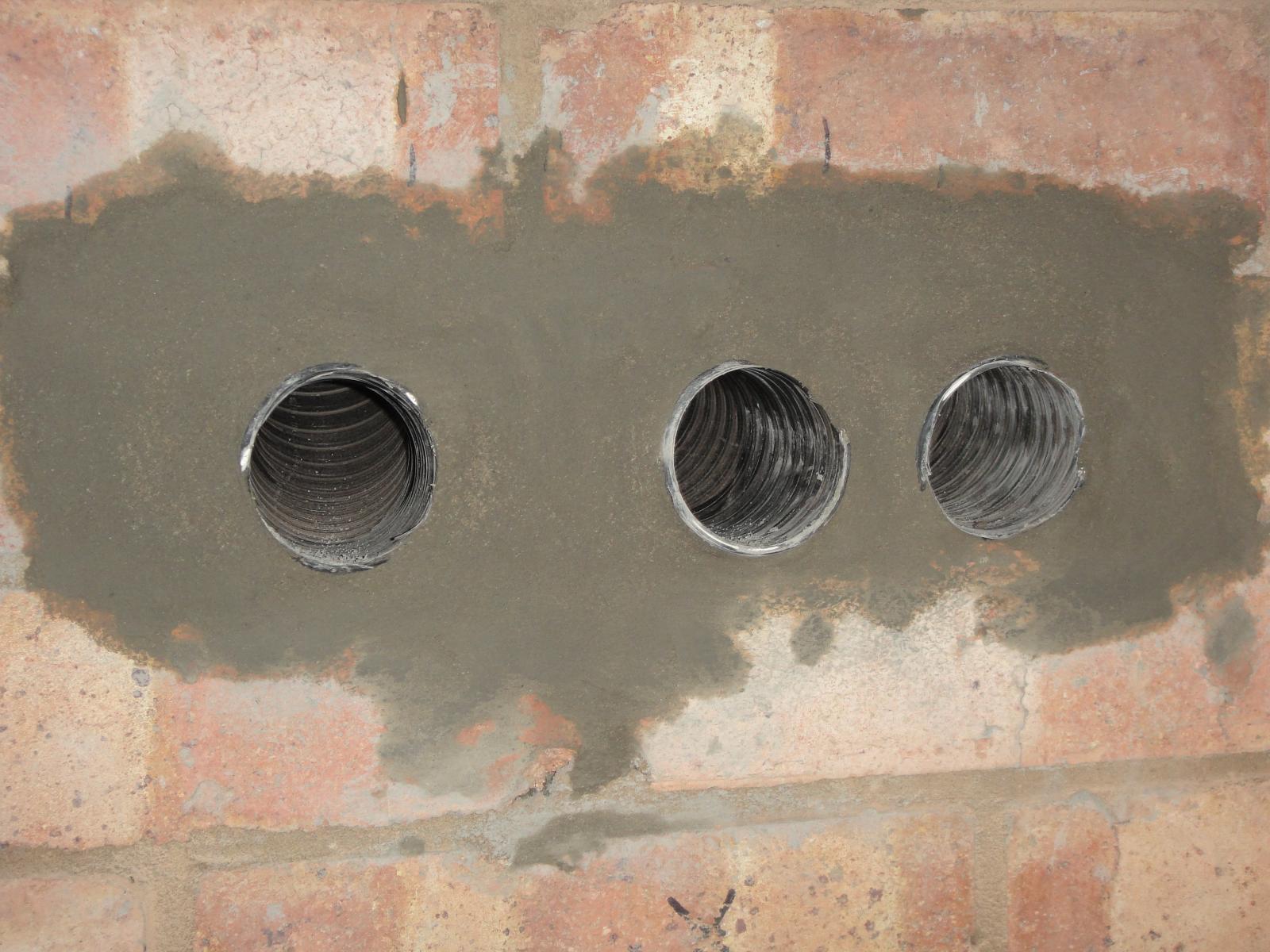

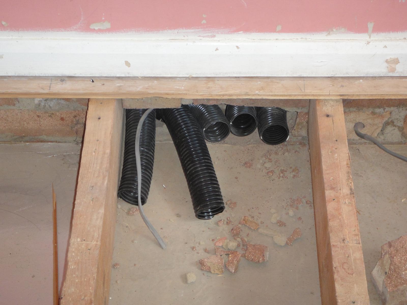

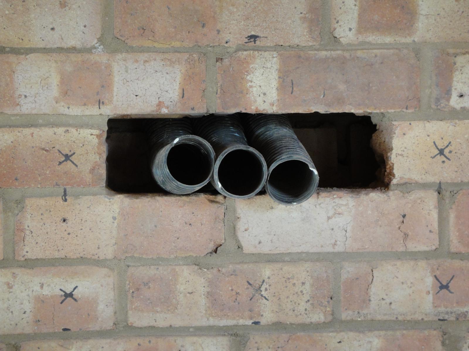

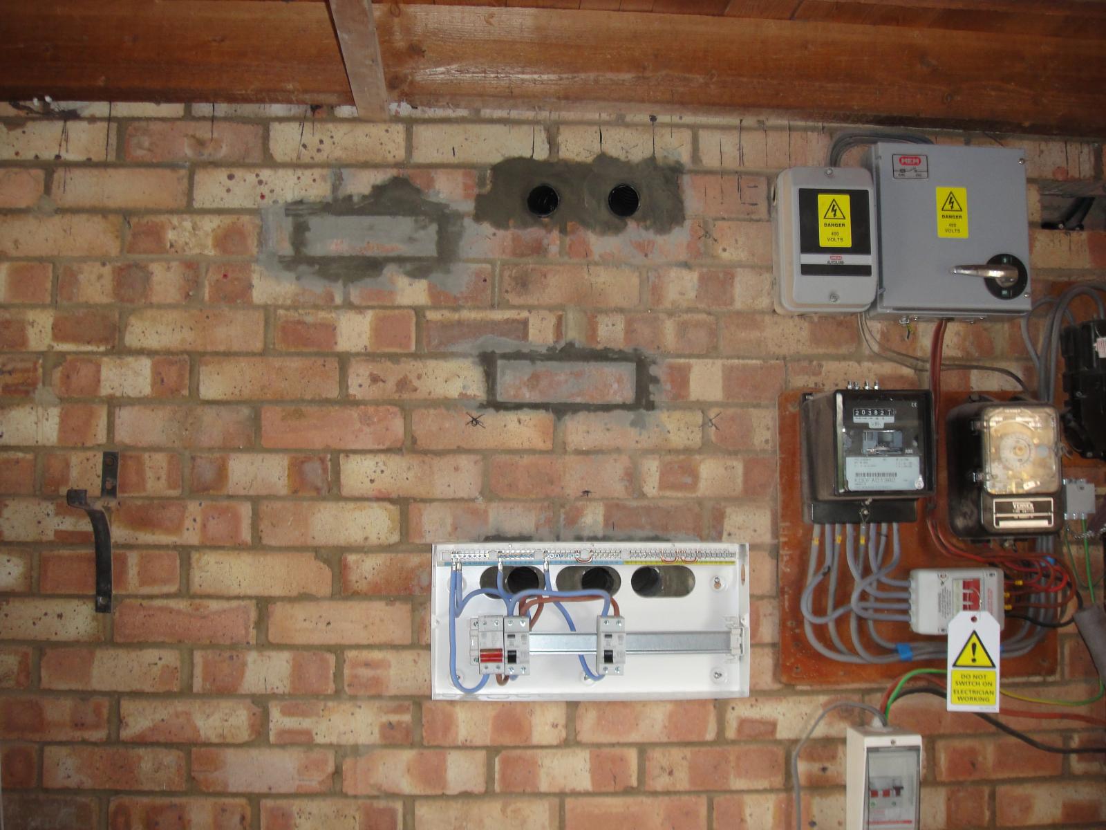

If you can get into the cavity you could drop pipes in like I did on a rewire, see pic below. Was a very neat job actually, the pipes only went up two feet in the cavity though, was a fiddle getting them in as they were 50mm.
As cables cannot just be put into the cavity without some form of protection from debris, falling objects, poly insulation etc, pipes was the best way, just popped up my local fish shop and it didnt cost much, ok it was a fiddle getting it in, but its done now and so easy to rod more cables through.

I reckon that would have been a b*tch of a job to get those pipes in but the end result does you full credit for a real professional finish! Get your label changed to "master craftsman working"!
Master craftsman... I don't feel that good yet, but I know I always do a good job, it probably took me an hour to get 5 pipes in, the cavity was only 60mm I think and the pipe was 50mm, that's why I had to knock a few bricks out to get it in as there were a couple of ties in the way! But yes, this was a job I was pleased with.

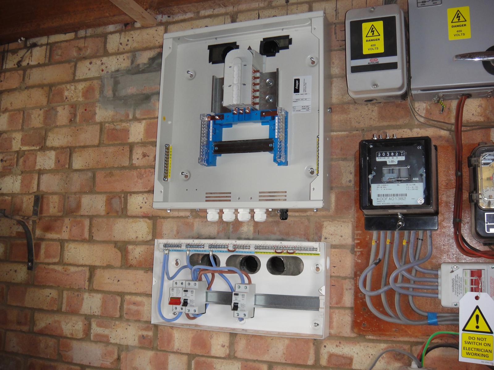

Looks like those compression glands are for supply tails , and db looks metal clad wot I'm getting at is metal ( ferrous ) enclosure just wondering if you have slotted knockouts or have tackled that in anyway? . Must say like the job very tidy will be making a mental note of you tekkers there .

Yes both boards are metal, the one at the top, the compression glands, I drilled these in ready to put the supply cables in as you pointed out and the little black one was to put the earth in. There are knockouts on the bottom board, I used them for trunking to the garage stuff etc and fire alarm switch.
Where I carefully cut out the top board to take the cables in the back instead of through the top in a header thing, I have superglued a rubber edge (got loads of it from eBay for next to nothing) on as per the photo below to ensure no damage can be done to the cables over the cut edge. I didn't do that on the bottom as the edge was very smooth and rounded over so didn't feel it needed it to be honest.

I'm was purely commenting on those stuffing glands as all live and neutral conductors should enter a ferrous enclosure via the same hole as to prevent eddy currents on you're earthed metal/ferrous enclosure ( db ) but a way around that is to cut a slot between each hole so I'm tolled , yes I agree you do a tidy job and obviously have pride in wot you do good job
I agree about the eddy currents, but to be honest, its only drawing 90A I think on the three phase board, about 30A per phase, it's not something I'm going to loose sleep over, yeah if it was significantly more then I would have put them in the same hole. The 24 hour board, they did enter through the hole on the right in one, it was only the top one that was like it. I appreciate eddy currents are obviously not made up, but at what current would you expect to experience them, or anything noticeable?
