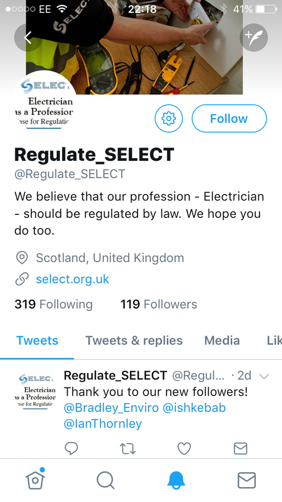

Just seen this on twitter posted by select. Reading some of the stuff Select post it's a shame they don't operate a CPS scheme in England...Their attitude/ethos seems to be one shared by most of us.

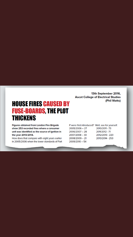

As a matter of interest how do you interpret those figures? Are they saying Part P has worsened the situation or what. That is a dramatic rise over those years especially latterly. What are we to make of them?
That was my thoughts too. It does seem like a spike in the last few years. An outlier if you will. I dont think you could say part p and schemes have caused that. As cowboys will operate and do jobs regardless and would have been doing them for years. If purely down to skills and experience you would see a more evem and balanced set of figures. That suggests its more likely other things such as quality of parts.. Poor cable selection cheap or fake parts etc... Ebay is flooded with them. So much so hager now print on numbers so you check each breaker on the hager website to see if its legit.
Reactions: DPG
It may be that reporting or investigation has changed or recording methods. It may be that many consumer units have reached there end of life and more prone to fire danger. It may be the market is soaked with people who do not know how to terminate cables. I wonder what it actually is?
  • Agree
Reactions: Pete999
It may well be that the standard of fire investigation is not what it was. When you are under pressure not to put "cause unknown" it's too easy to put electric.
How many of them are then interpreted as consumer unit?
  • Agree
Reactions: telectrix
There is some evidence (albeit anecdotal) that a lot of fires where the cause is unknown are put down as suspected electrical fault.
Unfortunately when trying to determine a cause, the figures on their own are meaningless.
it's all a case of treating the symptoms, not the cause.
the 2 probable causes are :
1. poor quality materials.
2.poor workmanship.
the latter being the most prevalent. entirely due to :
a. cowboys who don'tknoew any better and don't give a f*ck.
b. Electrical Trainee's who although keen, have insufficient training to do it right.
Reactions: DPG
That is two possibilities.
Others could be network problem, an increase in the load, external source, etc.
Reactions: Risteard
The market is full of low quality and suspect quality electrical equipment, if people settle for lower quality,
then they must accept the consequences of that.
