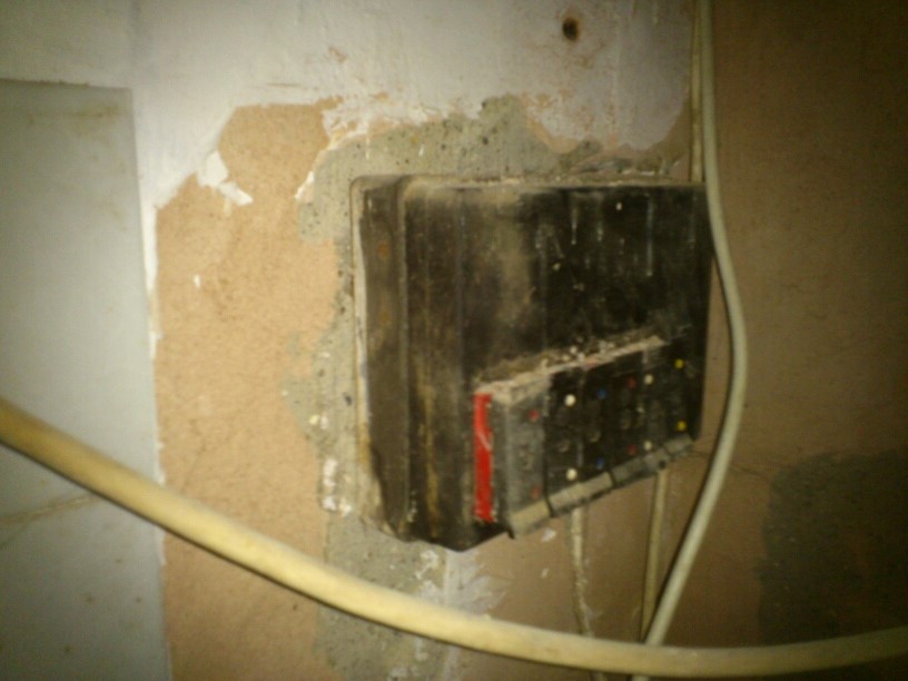

I have an interesting job coming up. Basically, my friend lives in old farm house in Lincolnshire, he is doing various other things, but has asked if I can move his consumer unit and upgrade it at the same time.
Ill do all the pre move checks, IR all circuits, Ze, Zs and check bonding etc and so on, hopefully nothing too bad will crawl out the wood work!
The existing board, from the photo he has text me, i think its an old 6 way Wylex looking at it, but its not that, its the location.
Its behind a big oil burner thing for their heating and in a kitchen cupboard behind it, im going to get him to move the surface as he is doing mods to the kitchen. The things I have a query with, I appreciate its probably an obvious one, but just wanted some ideas really.
I am going to move the box from in the cupboard (as you can see from the photo, stupid location!) to above the surface at a sensible height, its going to be a pain to do anyway.
What I am proposing to do is extend all the circuits, ill use heat shrink butt connectors, and wrap them all in self amagamating tape too, then run them up the wall in trunking, which is fine as they will be RCD protected by the CU. The shower and cooker, ill use correctly sized non-insulated butts to extend the T&E and wrap them which should be fine.
The issue I have is extending the tails, the meter is only the other side of the wall at the bottom, would it be ok to stick a 100A double pole isolator in where they are left and then run new cables up from that in trunking. I can't see why it would not be ok, the run would only extend it by just over a 1 meter which the total length would only be 2 - 3 meters then, plus he would have an isolator after the meter too. For the trunking of the tails, as they would not be RCD protected, do you feel it ok so stick them behind steel galvanised capping so they have protection, and earth the capping? I can't think of any other logical way of doing it. I do not want to bury them in the wall particularly, I guess I could fit an isolator in the meter box the other side of the wall and henley block the inside, running in the cavity is not possible as there isnt one! Doh!

It wouldn't be surprising to find this place needs a rewire, it all look pretty old, but looks can be deceiving. Galv capping would be a must on those tails, Iso switch is always a good idea and I think the length of the tails will be fine so long as they're the correct CSA. Farmhouses? Look out for that earth!

You can crimp the tails as a means of extension however if you feel the need to fit a DP isolator then that is also fine. If the tails are to be buried in the wall they will need mechanical protection (galv capping is not suitable to provide this) by means of steel plate (min 3mm), galv conduit or galv trunking or be within a cable with earthed metallic sheath such as SWA or one complying with BS8436. If run on the surface whether clipped direct or run in trunking, they don't need mechanical protection.

You're over-thinking this mate. Insulated and sheathed tails are perfectly OK on the surface without any additional mechanical protection, unless you perceive a specific risk of damage. By all means put them in a bit of trunking to keep them tidy, but no need to go over the top.
