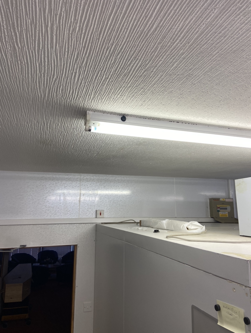

Local funeral place is getting a new mortuary fridge unit, and needs some work done.
The CU, just for the room, is high up in the corner, just above the fridge unit. Stupid place to have it, as you need to crawl over the top of the unit to get to it. 2 foot of crawl space, and my dodgy knee. Great.
Board just needs moved along the wall to above the door, everything in surface pvc trunking on wet wall panelling. No trouble extending circuits.
No room elsewhere to put it. Walls are lined with cabinets and other equipment. Above the door is an improvement, just not an ideal working height.
From what I can see, it’s an old Merlin Gerin board, no rcd.
Ideally, would change the board to all RCBO… but I can’t even tell how many circuits are off this board.
Going in on Saturday to PAT their equipment… so I’ll get up on the fridge for a better look.

Where are the tails coming in to the existing CU, could you tap into these and add another twin CU?
The supply is from a 32A mcb in the main board, so suspect 4 or 6mm t&e.. might be SWA.

why not find a suitable location outside of the room especially as the walls in the room are wet.?
I did think of this, Tel.
Back to back is the chapel of rest room… (where the door goes) and there’s nothing on the wall.
Could leave it in a corner, but bring it down to a manageable height.
I don’t really know how “wet” the room gets. Nothing is IP rated, no drains on the floor or anything.
I think it’s just been wet wall panelled for ease of cleaning.

I think the room had been wired before they thought about where the fridge was going.
Maybe the original unit was only one door, 3 drawers… and they’ve upgraded to twice the size, hence blocking access to the board.
Now they’re upgrading again… slightly larger unit. No more capacity, but around 8 inches wider… more insulation maybe??
The old unit is going up to their other premises. A garage where they keep the limos and 200 odd coffins.
I’m moving the light at some point as well..
Switch is getting blanked off, new fridge is wider and will cover. Hoping I can pull cables up into that trunking to joint. (In a box, not joint in trunking)
Still a working switch at other door.
Wall is brick, so putting things on other side of wall could be messy.

True, though a masonry/diamond hole saw would allow a neat 2-3" hole to be cut for cables to go therough and you could have trunking running down on the other side to the CU.
Don’t want to damage the decor on other side of wall, it’s the Chapel of Rest.
Crawled over the fridge and took cover off.
I can see now the wet wall cut around this… so I’ll repurpose as a joint box and run extensions along the 2x2 below.
