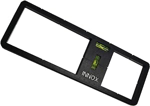

I find myself in the position of having to fit a few back boxes in to plasterboard. In the past for the odd one I just used a hand plasterboard saw to cut out a hole, but I wondered if anyone here has used something like the square/rectangular cutter adaptors you get for multi-tools to do this sort of thing. If so, how well did it work?
Suggestions for make/model?

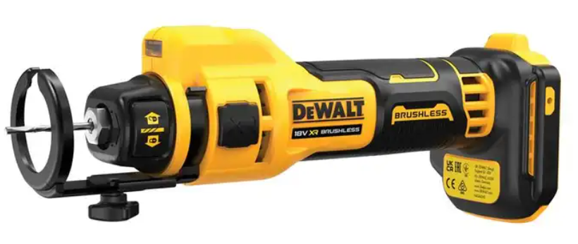

I have used every tool known to man for this task! I have a dedicated mini-router which is very fast, and a mutitool which is also fast...they both create a lot of dust.
A sharp jab-saw is fast and accurate, creates much less dust and "swiping" the edges of the cutout with the back of the blade creates very accurate and "squared-off" apertures...and it doesn't need any power from mains or batteries, so all in all it's ideal for a few cuts in an occupied property. The mini-router is so fast though...if property is unoccupied and dust isn't a problem, it is super fast, and with the correct blade can trim very accurately. I love it...but it is a last resort if I want to minimise dust.
