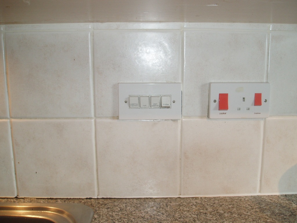

P6280020.JPGHere is another view they did a few years ago that i got called out today instead 4 seperate switches there are 4 on the grid great you say but they are MEM and you cannot get them (unless you know)
