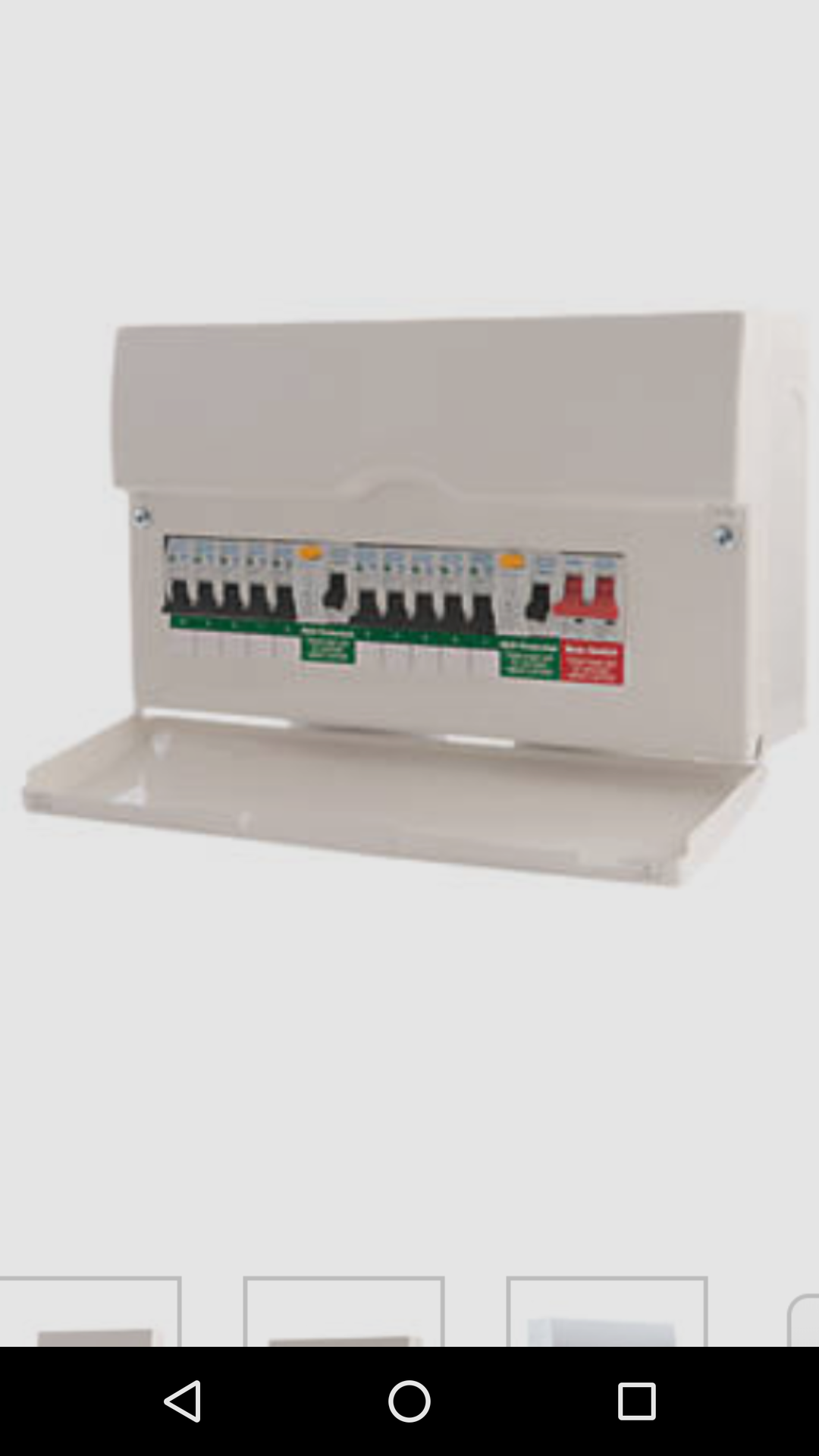

The other question is.... are you sure it is an mcb? It might be an RCBO... trips off under a different type of fault.
Can you photograph the mcb in question and post it to the thread here?

What is tripping out the 6A circuit breaker RCBO or RCD (photo would be helpful)

As for the fuse that's tripping on CU, I have the BG 10way unit from screwfix with RCD switches too. The one that's tripping is the 6amp marked ground floor lights .
I will try get a picture up as soon as I figure out how to.
