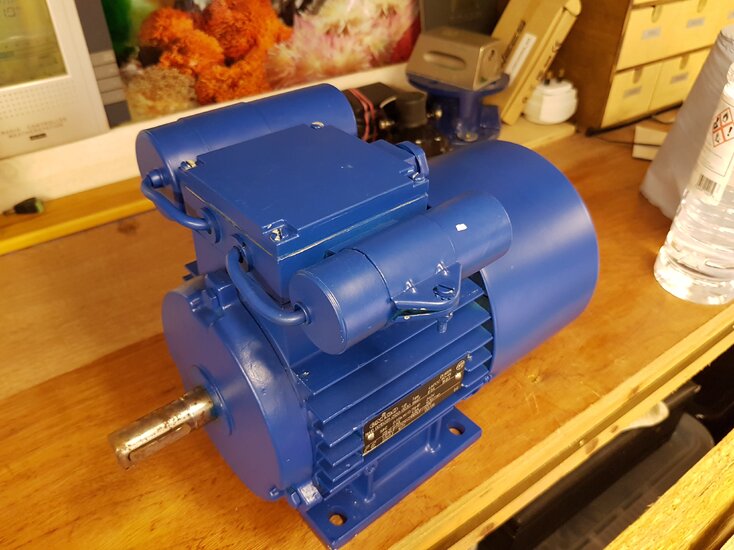

I am having problems with a motor on my home made 2 x 72" belt grinder

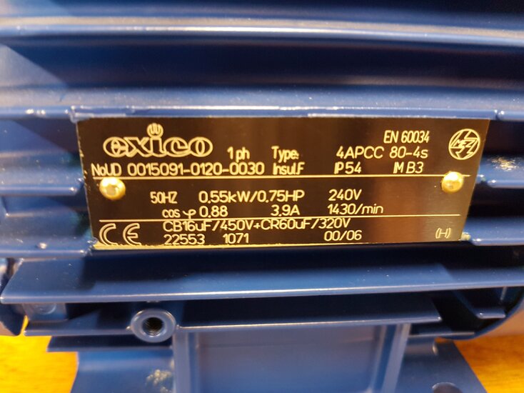

20160912_131251.jpg This is the motor

I changed the start capacitor for a 60 uf which I believe is the same as the original one as I cant read it as its been sprayed over, but looking at plate it does say 60 uf .

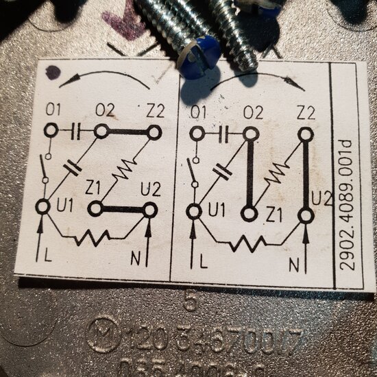

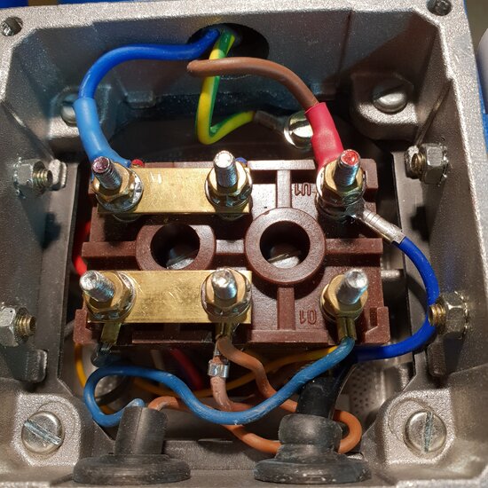

I cannot see how you have done anything wrong here be it via a plug or a dol starter, the only problem you could have introduced is where you connected the 230v in the motor circuit, do you have a pic' of the connection terminals and any wiring diagram supplied as they can vary according to motor wiring layout.

Edit - connections seem fine.

This is a Capacitor Start & Run motor. The 16μF run cap is always in circuit with the Z winding. When the centrifugal switch is closed, the 60μF starting cap is connected in parallel making 72μF. If the 60μF start cap is bad, it will lack starting torque but once it gets up to speed, the run torque will be normal. If the 16μF run cap is bad, it will start fine but lack torque once the centrifugal switch has opened.
As per Darkwood it sounds like the run cap is bad. The best test is substitution, as caps sometimes break down under working conditions but test OK on resistance and capacitance tests. If you like, check you have continuity through both windings U1-U2 and Z1-Z2, and if convenient test the insulation from one winding to the other and both to the frame if you like (with the caps out of circuit!) but the run cap is the prime suspect. If left connected to the mains with a bad run cap, the windings may be damaged, but you would probably have noticed it overheating at that point so hopefully this hasn't happened.
