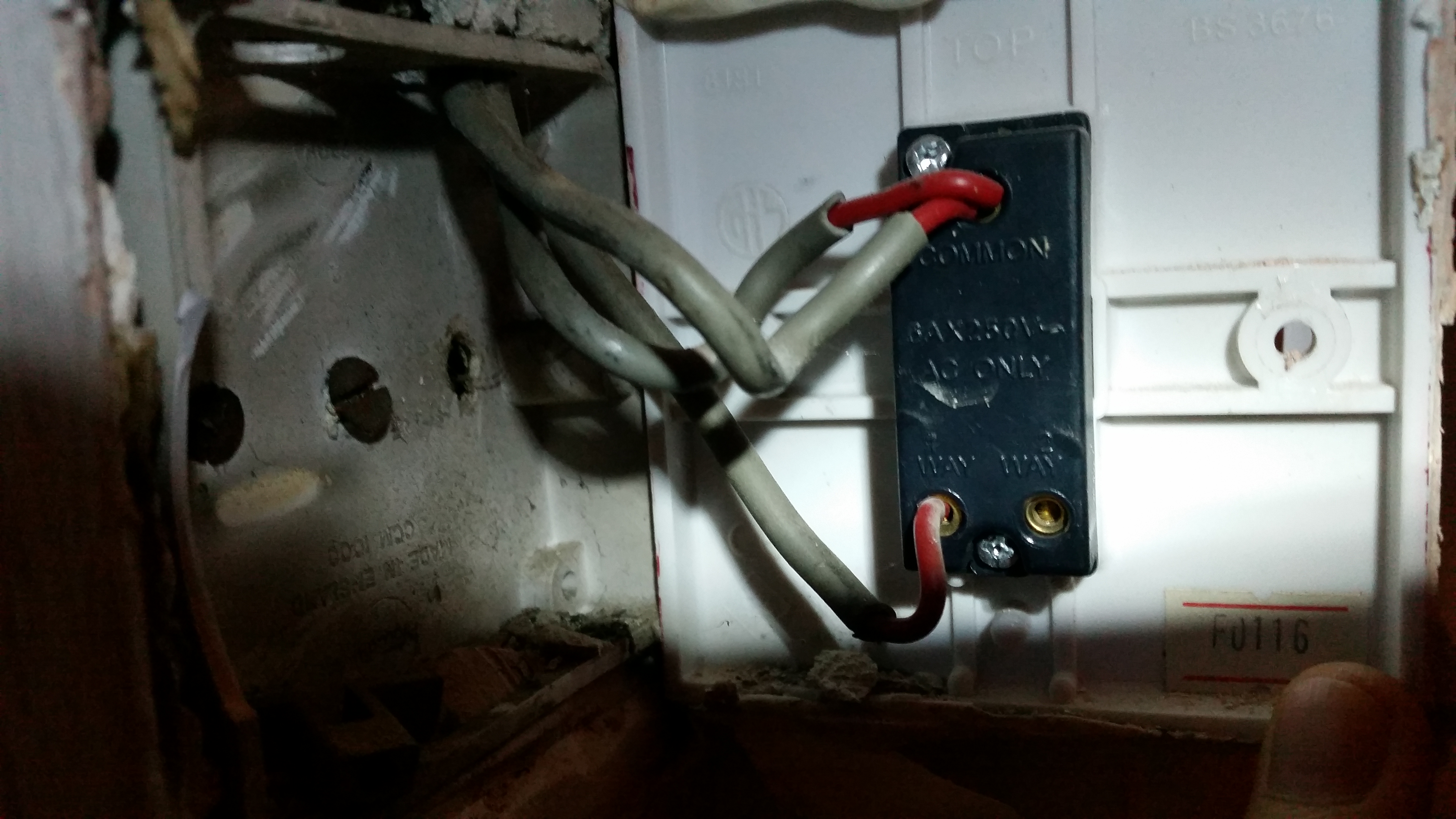

Here's the wiring at the switch
I'll connect the earths now, I'll need to strip, would not connecting the earths stop the light from turning on?
@gaz_sparky
Looks like I'll have to cut more holes for that missing a cable

This is speculative but shouldn't cause a problem. Put the browns at both roses together at the terminal the brown from the flex is connected at. If this fails you need the services of an electrician as there has obviously been some modifications taken place. ISOLATE THE POWER FIRST.

Judging by the red singles in the switch this installation is very old. I suspect Diazed fuses are probably still in service, and the Earthing and bonding as well as meter tails are likely to be inadequate. The main protective conductor (neutralising link) may well also be undersized.
I would strongly recommend that a Registered Electrical Contractor be contacted and a Periodic Inspection Report be commissioned.

Personally I would suspect that the switch wires goes into a junction box somewhere and the lights are fed from there, in which case the brown conductors should be looped together in the same terminal with the brown flex at the first ceiling rose, then the single brown and the the brown flex together in the same terminal at the last rose.
But my advice is to get in a spark to check it out as there are no cpc's connected which could/will be a problem especially if you have any metal fittings anywhere on this circuit. There could also be other defects which you may not be aware of that might affect the safety of this install.
Hidden junction box somewhere. Is there easy access from above?
I agree with westward and intoelectrics, connect the browns together and it might work.

My gut feeling is that there was originally one centre light in the room which then got converted into two lights.

Putting all three browns together at one terminal and all three blues together at another terminal done it
I even stripped backed the wires and put the earths together
