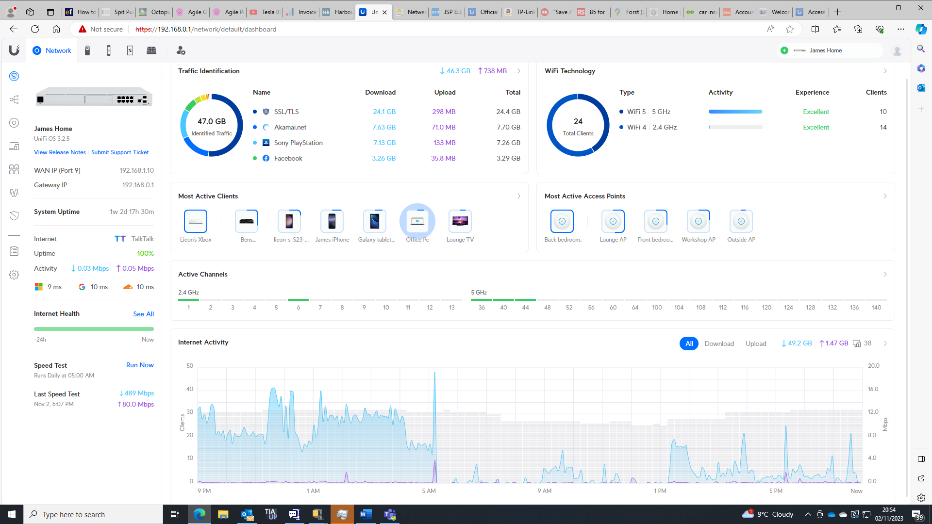

Ubiquity are a good choice (our ISP uses them for professional side), I have also had good enough results from Netgear access points, and from TP-link as well for cheaper end.
Using a PoE router is a good idea as (many) cameras and WiFi access points then don't need a separate power supply as the ethernet cable provides power anyway.

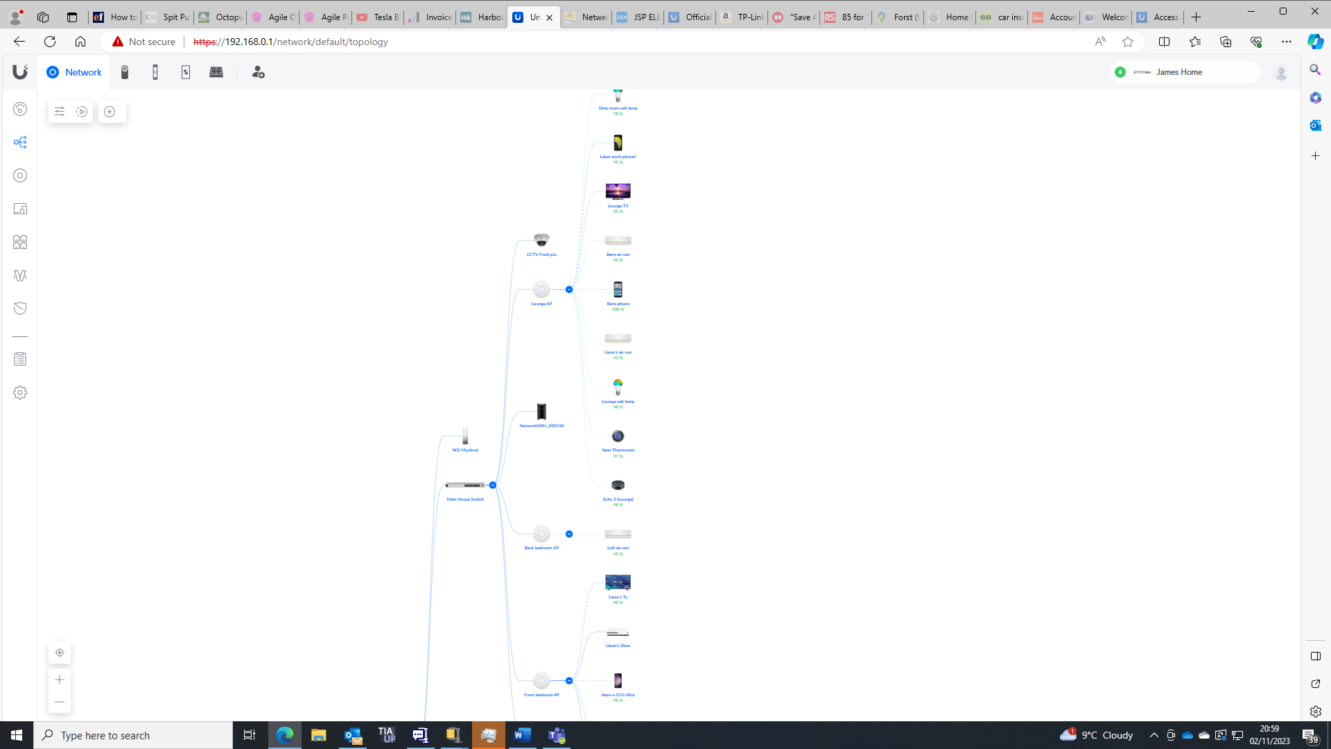

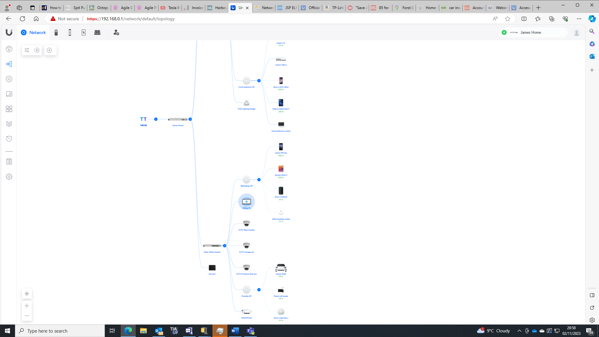

I had a wireless access point & switch in the attic of my last rented bugalow (a reporposed BT home hub with openwrt), the existing phone extension went up the exterior wall and into a breather brick thing, so I clipped in some external grade cat5 along side of it and into existing phone / fibre backbox. So no extra cables came through walls or ceilings, i also had a cable going into the garage.
It was a stealthy way to get full fiber speeds in the lounge, garage and wifi coverage throught the house and driveway, Its nice to download podcasts in seconds while warming up car for work.
