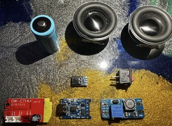

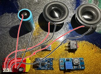

Please help me how to wire this, it’d be awesome if someone draws a simple diagram like the pic I posted but for my parts, I saw a diy video on YouTube for this mini subwoofer but it’s not clear where all the wires go. It’s only clear for the one speaker set up here in the diagram pic but there’s no diagram for the 2 speaker set up.
These are the parts used
1.mt3608 dc step up converter
2.18350 lithium battery 3.7v 900mah
3.dc 3.7v 5v 3w audio amplifier board
4.3.1 type c connector 5.5v 1a type c micro usb charger
6.4ohm 5w speakers
7.on/off switch

Does it say what impedance speakers the amplifier is suitable for driving? Also what impedance are your speakers? (they will probably be marked 4 or 8 Ohms).
This will decide whether you wire your 2 speakers in series or parallel.

I really don’t know, I just know the speakers are 4 ohms. Here’s a pic of how the guy wired it all up, but I can’t tell where all the cables are going. I can post a link to the video if that’s allowed, y’all would definitely know how to wire this if you see the video, but I’m a noob still.

That picture shows a different amplifier board - it has 2 speakers outputs.
Having said that, you can connect your 2 speakers in series to your amplifier:
Amplifier --> speaker 1 positive
Speaker 1 negative --> speaker 2 positive
Speaker 2 negative --> amplifier
Your pic of your red circuit board shows the speaker connections are the white sockets, labelled Lout + and - for the left speaker, and Rout + and - for the right speaker.
The latest photo from the video shows the other side of that circuit board with the speaker connections directly soldered to where the connectors are on the other side of the board.
So either use the connector if the mating parts are supplied, or solder the wires as per the picture!

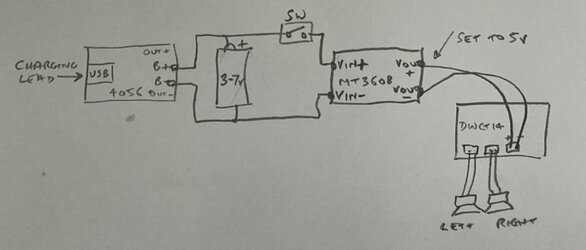

OK I understand better what you need now.
I've looked at the modules you have, and I'm not sure why you need the MT3608. You might get a bit more power if you used it, but to safely use it I think it would be a good idea to use a multimeter (well, voltmeter) to set it to the correct output voltage.
Your battery is 3.7Volts. The amplifier runs from anywhere between 3.7V and 5 Volts. The MT 3608 power module boosts the battery voltage, adjustable via potentiometer, up to 24Volts, which may damage the amplifier if you turn it up full.
So if you want to use it, you will need to set the output voltage of the MT3608 to 5V before you connect it to the amp.
I suggest you try the amplifier without the MT3608 module, at least to start with.
Basically what you have drawn (in your first post) is correct. Combine it with what you've put in your second sketch (Leaving out the MT3608!)
I hope you can follow my description below, instead of me drawing a diagram, but I can do that later if you need!
I'm assuming you have the flying leads with connectors that came with the amplifier (shown as included in the ad I looked at) but if you haven't you will need a soldering iron!
Wire the battery, USB charger, and the red/black battery cable with the red plug, all as you have drawn. But using your red amplifier PCB instead of the one in your first drawing.
Then solder, or connect however you can, the two white speaker leads with connectors and plug them into the white sockets on the amplifier pcb.
I think that completes the wiring, so charge the battery and see if it works!
Let me know if I've missed anything!
PS: to get any reasonable sound out of the speakers you will need to mount each on a baffle, or in a cabinet or box of some sort.

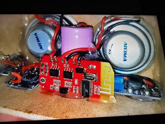

Here’s the link to the video, if you have time to watch it you’ll understand way better exactly what I’m trying to do,
not sure if links work here. And yes I’ll make a mini subwoofer box like in this video, I just need to understand how this little set up needs to be wired then I’ll buy multiple of the same parts and make the same set up but with many different subwoofer boxes and all that.
This info is gold to me really I really appreciate it, if you don’t have time to draw the diagram using the mt3608 I’ll just try what you said but I have time to wait :D
So in the video (but not included in what you see) the constructor has de-soldered the USB connector on the 4056 battery management board, and he uses a separate c type connector pcb which he mounts in the side of the cabinet, but it's not possible to see all his wiring.
I could guess, but I won't.
If you want to use the c connector board that you've got in place of the usb already on the 4056 board, I'm afraid you'll have to work that out. It should be just usb power from the c-type to the corresponding polarity pads the 4056 USB connector was removed from.
I also note in the video the switch is single pole two way - is that used to switch between Off/charging and On?
Yours is single pole on/off, so I've put that switch on the load side, leaving the charging permanently connected.
Initially it might be safest to take the power for the MT3608 from the power out tabs on the 4056 board instead of directly from the battery. But once you start using this in earnest I suspect you will need the oomph you can get directly from the battery to drive the speakers, and I don't know what current limiting properties, if any, the 4056 charging board has.
Do be careful, lithium batteries can release a lot of energy and you don't want to be shorting it out and causing an explosion or fire.
If you see alternative, or completely different, suggestions out there, feel free to adopt such!
Actually on the issue of safety, if it were me doing this I would put a fuse in the +ve battery connection as near to the battery as possible!

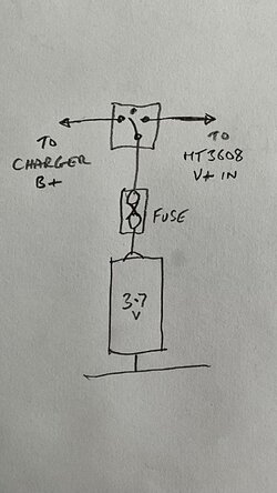

If you had a centre off 2-way switch, so one way was charge, centre was battery disconnected, and the other way was "On" I guess that might be safest.

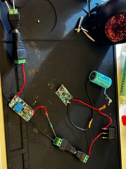

So this switch in the pic should work better right?
It won't work 'better'. It would just be a different way of doing it! But I understand what you mean, would it make your speaker setup better? It would mean you could turn the unit properly "off", whereas in my sketch the charger is permanently connected across the battery, which I think should be OK, but I haven't seen any technical info to justify that assumption!

I’m just unsure if I will be able to wire everything with the center off switch and the fuse since it’ll change the set up a bit.
Putting an in-line fuse in the wire from the positive battery terminal before it goes off to wherever the circuit shows is hardly a significant change, and would provide protection where at the moment there is none.

Awesome, I’ll buy the fuse and the center off switch and finally try to wire it all up. Thanks for all the advice, and yeah I was aware that these batteries can be very dangerous but I actually forgot, thanks for the heads up 👍
I’ll post it once I try it all out.

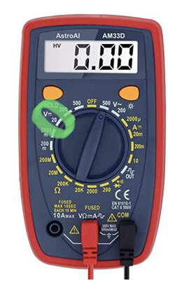

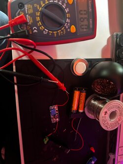

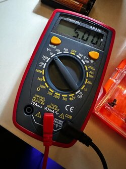

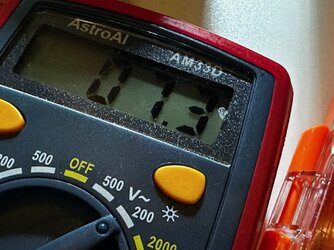

So I’m trying to set the step up converter to 5v and for some reason it only lets me go down to 6v, Is my voltmeter a cheap one and just not reading right or maybe I’m doing something wrong? I tried turning it both ways.
