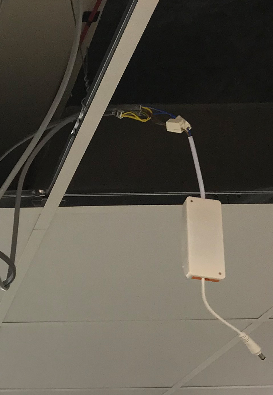

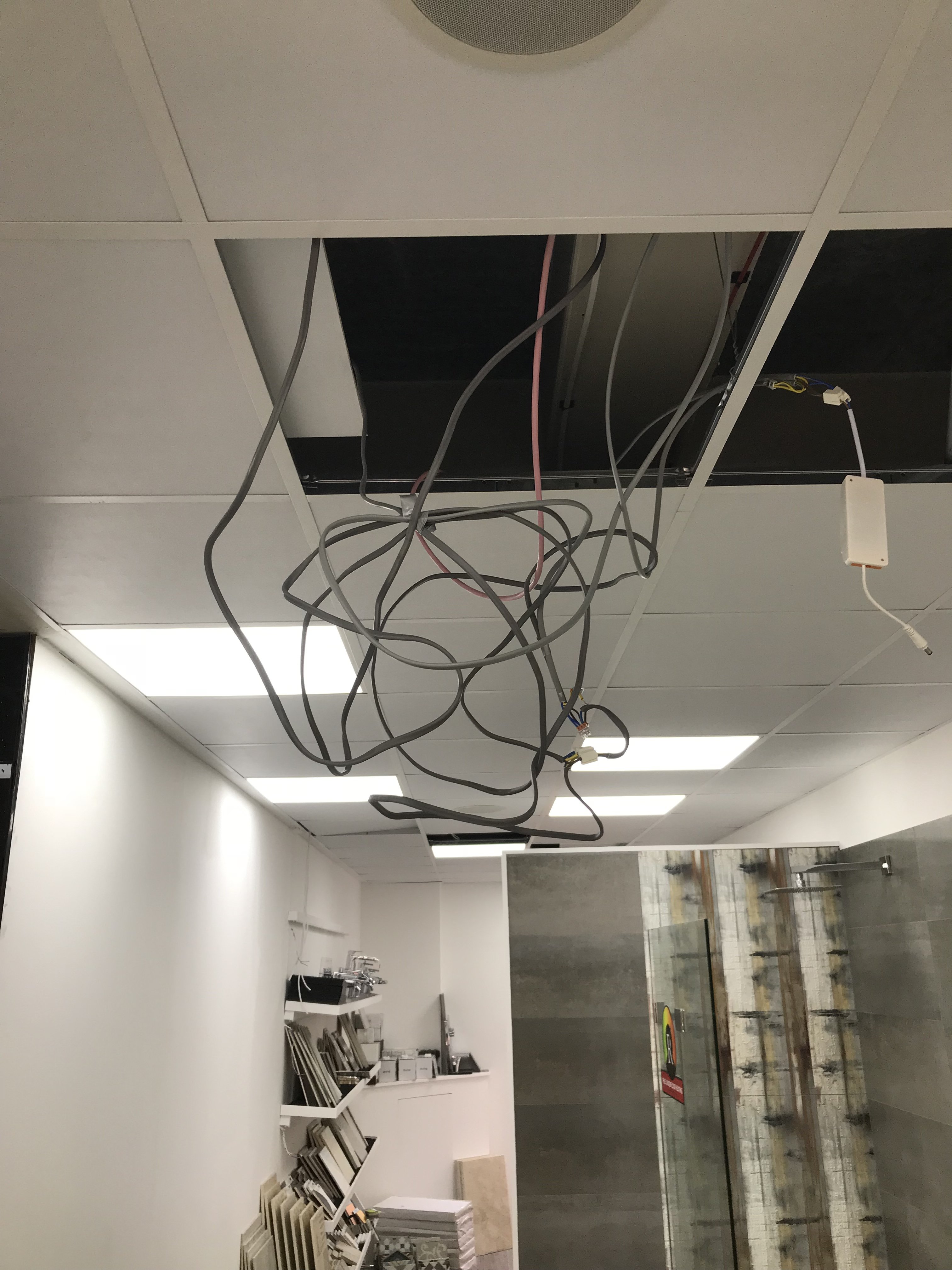

Got called to a job where the entire installation was fed above a suspended ceiling on a commercial premises wired a few years earlier. All the cables are draped across the ceiling grids, all light fittings not double insulated and made off poorly with the possibility for the grid to become live, all lights wired in a spaghetti junction on cabling, circuits overloaded and switched on caused mcbs to trip out in the mornings. No proper design whatsoever...was a complete mess. plus the grid wasn't earthed either...

Lights not double insulated and cables draped across ceiling grid.

You are getting double insulated mixed up with insulated and sheathed . You are correct in that the brown and blue insulation should not be visible and suitably enclosed .
By all means rewire the lot . Or remake all the fittings off and secure the cabling with all round band
It certainly can be tidied but if you intend to put in place a new system is the ceiling grid staying because if so that can restrict whatever you intend to do.
Yea sorry guys I miss wrote the first post as double insulated lights, I meant double insulated terminations and in a enclosure.

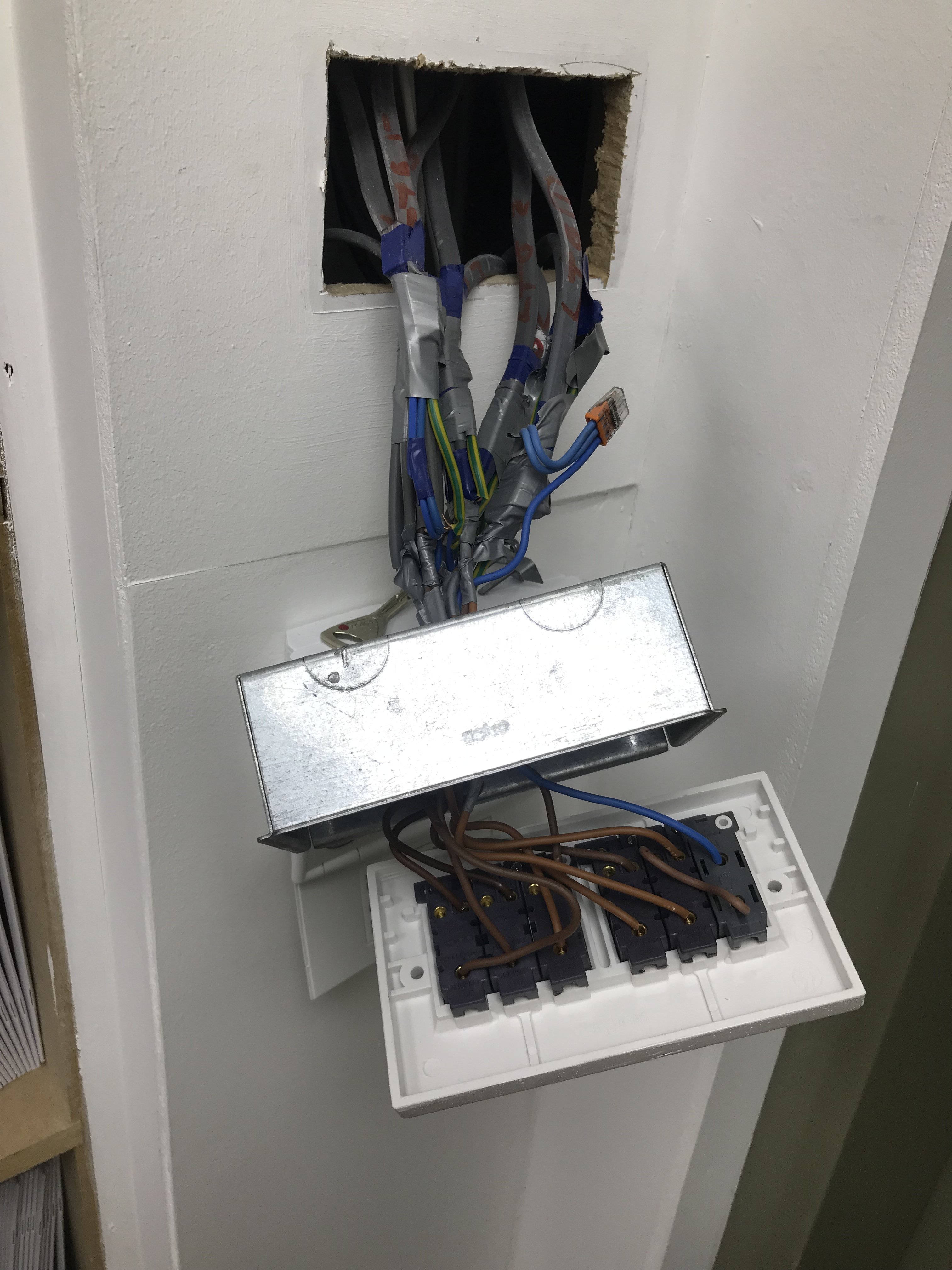

This is just one aspect of cabling above the ceiling and there was much worse found above with multiple joints everywhere. there is also multiple wall lights/mirrors everywhere (its a bathroom showroom) so in other areas there is joints up to 8 cables in more going in all directions not within a enclosure.
The ceiling grid will be staying up and all I can do really is take down all the tiles and lights down one side of the room to run conduit/singles easily.
You could use a load of Hager J501 boxes, flex out of them to the lights, or put clix in. Use all round band to fix to the ceiling and conduit boxes to fix the clix to. I've seen worse.
