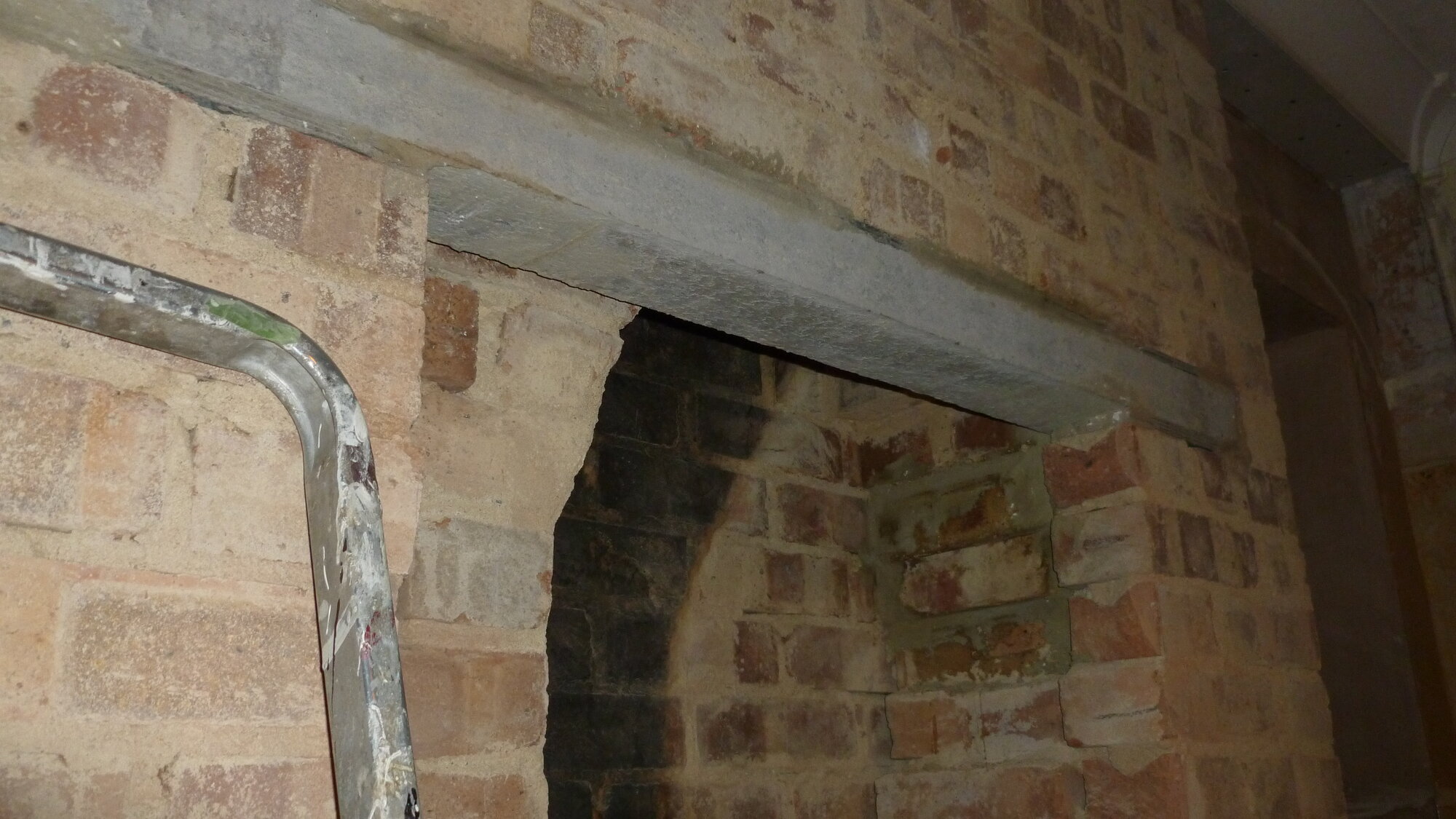

I am refurbishing my kitchen - I have opened up the front of a chimney breast which is directly in the middle of the wall where my kitchen units are going (and previously were) - the chimney breast is only around 280mm deep so I am making up a custom
extractor/down light rig.
this is what I want to do:
# 2 downlights in ceiling above area where hob will be (in front of a chimney breast which has been opened up)
# 2 downlights inside chimney breast either side of an extractor fan (see below)
# Extractor fan (Manrose XF150 220-240 volts AC. 50Hz. Single phase consuming 20 Watts)
I want to have an on/off switch for each of the elements above.

You say there is not enough depth for a normal extractor? can you provide a drawing or photo to clarify that?

The depth is 265mm deep (I said 280mm earlier!)

BTW the internal bricks to the chimney breast (left hand side of the breast) that formed part of the internal 'turn' for the flue are going to be removed.

Yes those switches would be fine but I echo Mike's view here you shouldn't use that extractor for the removal of cooking fumes as it will clog up with grease etc and seize. If you get a purpose made hood extractor it will come with lights and control switches.
