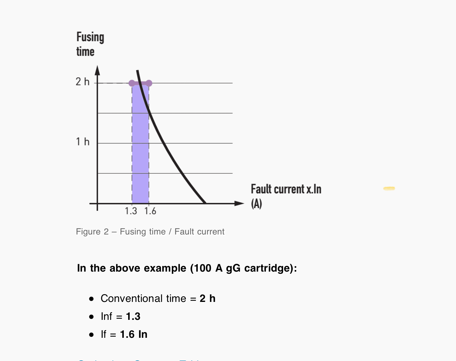

Stating the obvious - the 100A fuse is there for protection against sustained overload, or some major mishap. Design standards require it to withstand a load of 1.3 x rated current indefinitely. 1.6 x rated current for 90 minutes. You've got to go some to blow it. I feel the power factor considerations you are concerned about are really neither here or there in the grand scheme of things.

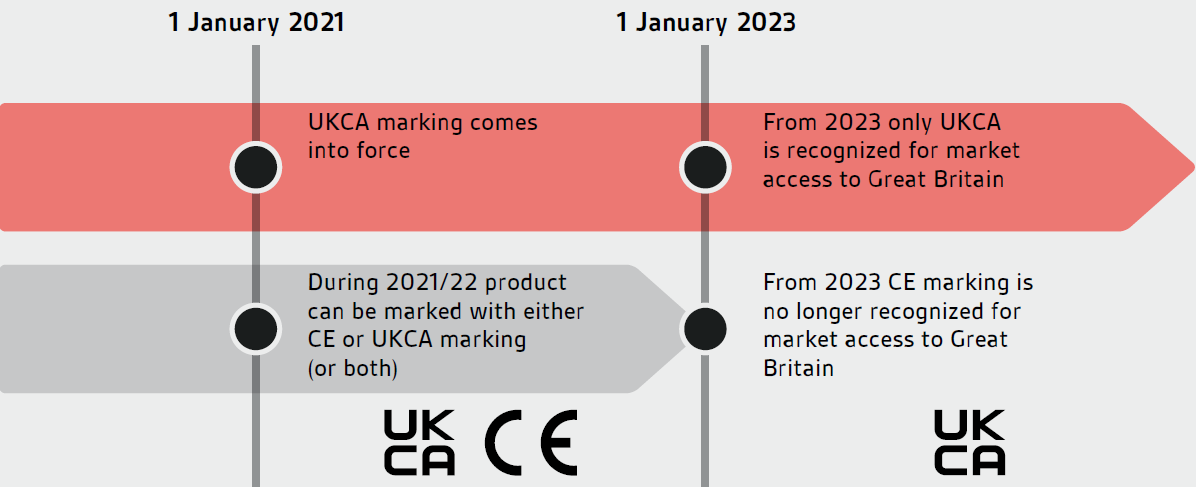

I will now look at the links which you so kindly supplied, because the Omega continuous current monitor which I was looking at is not suitable for my needs (it has a memory capacity equal, at the highest sampling rate (once per second), to only about 9 hours' connection time, after which it switches off, and, as regards battery life, it can't, as it stands, be run from a mains-powered UPS,
And, it appears, it does not have CE approval so can't legally be sold in the UK - until there is a post-Brexit British Standard drawn up for the compliance to which it can be approved.
I was surprised by this, because, as with so much which was supposed to be part of "our own sovereignty" post-Brexit, I was under the impression that the UK was still recognising CE compliance, at least for devices which already have it.
I did have to ring Omega to discuss this monitor, but the technical man, Alex, was so pleasant and (within reason) helpful, that I did not grumble about not having had a reply to my message.
It is possible the device does not fall under any Directives that require it to be CE marked.
It is battery powered (under 50V), so does not come under the LV Directive
It may be regarded as electromagnetically 'benign' so would not come under the EMC Directive,
Alternatively, like many electronic sub-assemblies, it may be for incorporation in an overall system, and thus be outside the scope of the CE Marking Directive itself.
With regard to post-Brexit arrangements, the process is in hand.
If UK manufacturers want to sell in Europe, they will still have to comply with EU CE marking procedures.
To sell in the UK they will from 2023 comply with UKCA marking procedure.
Until 2023, both schemes are valid in UK
I knew vaguely about the above, so your neat diagram is useful. Many thanks!
Do I understand you correctly that CE approval is probably irrelevant to this device, anyway?
I'm merely curious about this, because the monitor is apparently on sale (at both Omega and Farnell), even though it seems not be what I should be buying!
The phone connection with the guy a Omega was not good, so he might have been referring to a different monitor, with a larger sampling memory, which he mentioned as one that they could not currently sell in the UK (or in the EU??).
But I pressed him on this block, and he seemed to be sure that it applied to the OM -DCVC. Seems odd, when it is for sale.
