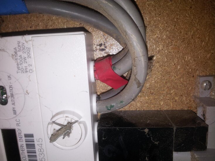

Who needs henly blocks anyway, check out this beauty i came across last week, best part is the meter man resealed it!
