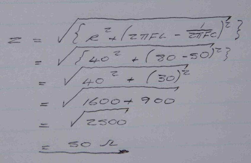

a capacitor of capacitive reactance 50ohms an inductor of 80 ohms inductive reactance and a resistor of 40 ohms are connected in series to a 200v 50hz supply the impedance will be:
the answer is 50ohms but i dont know the workings out.
anyone know how to do this.

Hi there,
I hope this helps...

Hi there,
Ericks is correct. It is a very standard question. Capacitive reactance and inductive reactance act in opposite directions to each other and so you just take the difference between them - in this case it is 30 ohms. You are then working out the third side of your impedance triangle, using pythagorus. You have R (40), X (30) and the hypotenuse of triangle is Z. It is very common to have these 3, 4, 5 triangles or multiples of eg 6, 8, 10; - 30, 40, 50; - 60, 0, 100 etc etc :)
