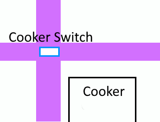

With respect to the cooker switch only. If I moved it 400mm to the left by extending the T&E from its original position using crimps, then tile over the original back box, would it satisfy regs by maintaining the modified circuit within the prescribed zone (assuming all other rules are satisfied)?
I’m aware it will create a new zone vertical to the new switch position, and the outlet will be moved to conform. Its just the movement of the cooker switch I need clarity on. (Moving is the only option available, a new chase is not possible).

If the existing cable runs vertically up or down then you will need to keep the back box and fit a blank plate as there will be no indication there is a cable in the wall......or rip it out and run new cable
Only by doing as Markyd says by fitting a blank plate on existing box so that the existing vertical cable run is obvious.
Thanks for the response. The existing cooker switch has the outlet beneath and the extractor take off point above (see image). So by moving the cooker switch to the left, I should be able to bury the old backbox without a plate as the vertical zone should still be preserved?

Still in the zone.
I’d be inclined to make the joint below the worktop, take it to the side then up to new switch.
Then joint is accessible to a point… have to remove cooker, but it’ll be there.
Only good if cable comes from below.

Still in the zone.
Cable comes from above and there is no slack to pull down further.
Nonetheless, its great to get confirmation from you guys that I'm within the regs doing it this way. I'll crimp and maybe solder.
There may be a removable splashback going behind the cooker allowing access for checking the joint in the future. Ultimately, I'd prefer no joints on this circuit, but sometimes you have to work with what you have.

The cable is stuck firm in the chase. Its been plastered over with no channel cover. I was hoping to put a junction box in the loft and feed a new 6mm down to the isolator.
