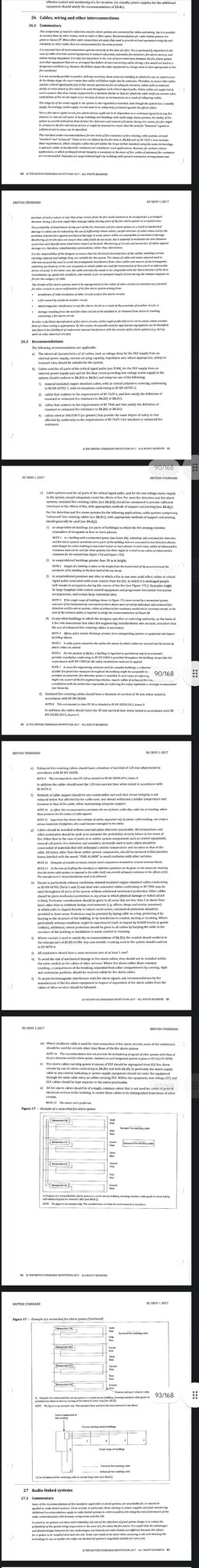

I have what I think are the up to date versions (5839-1:2017, 5839-6:2019+A1:2020)
Section 26 in 5839-1 refers to "cabling, wiring and other interconnections", mostly talking about fire resistance, but also has this section:
It is the responsibility of the designer to ensure that the electrical characteristics of the cables, including
current carrying capacity and voltage drop, are suitable for the system. The choice of cable and routes
selected need to take into account the need to avoid electromagnetic interference from other cables
and sources of electromagnetic radiation, particularly in the case of systems in which cables are used
for transmission of data (such as addressable device circuits). In the latter case, the cable selected also
needs to be compatible with the characteristics of the data transmission e.g. speed and waveform, and
remain so for an adequate length of time during the relevant exposure to fire for the category of cable.
The circuits of fire alarm systems need to be segregated from the cables of other circuits to minimize any
potential for other circuits to cause malfunction of the fire alarm system arising from:
• breakdown of cable insulation of other circuits and/or fire alarm circuits;
• a fire caused by a fault on another circuit;
• electromagnetic interference to any fire alarm circuit as a result of the proximity of
another circuit; or
• damage resulting from the need for other circuits to be installed in, or removed from, ducts or
trunking containing a fire alarm circuit.
If that adds any clarity?

Dump of 26 to aid discussions
