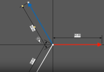

I don't know if this helps or confuses more, but sometimes seeing it visually can help.
If you consider a 5 amp load on each phase, with a scale of 1 amp = 10mm, and the phases 120 degrees apart you get a vector graph like this:
If you arrange the vectors after each other in phase sequence, you end you back at zero:
The key point is that as the phase angles stay the same, you can't ever get further away from the middle (0v) than the magnitude of the longest vector, so the greatest possible N current is that of the largest phase current.
Or to say another way, if you take any three distances A B and C, and walk each in turn, turning 120 degrees in the same direction after each one, you cannot end up more than the largest of A, B or C away from where you started.
