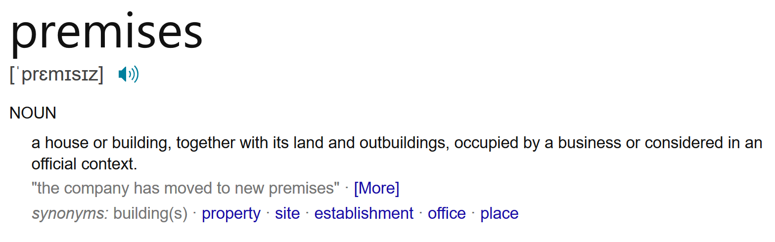

Unless the garage is attached to the main house. In which case the new consumer unit should probably be made of non combustible material.
Unless the garage is not part of the domestic premises
and is not meant to be used by the people who live in the house, then 421.1.201 applies, whether it's attached or not.
Fair point.
There was an article in one of the trade journals considering this. It suggested there may be a case for not applying 421.1.201 in out buildings that are not directly attached to the house.
But it depends, like so many things, on how we interpret the regulations...
Fair point.
Hard to think what that case might be apart from "we don't want to have to apply it."
I tend to come down on the side of "interpreting" things on the basis of what the actual words are and what the definitions of those words are.
