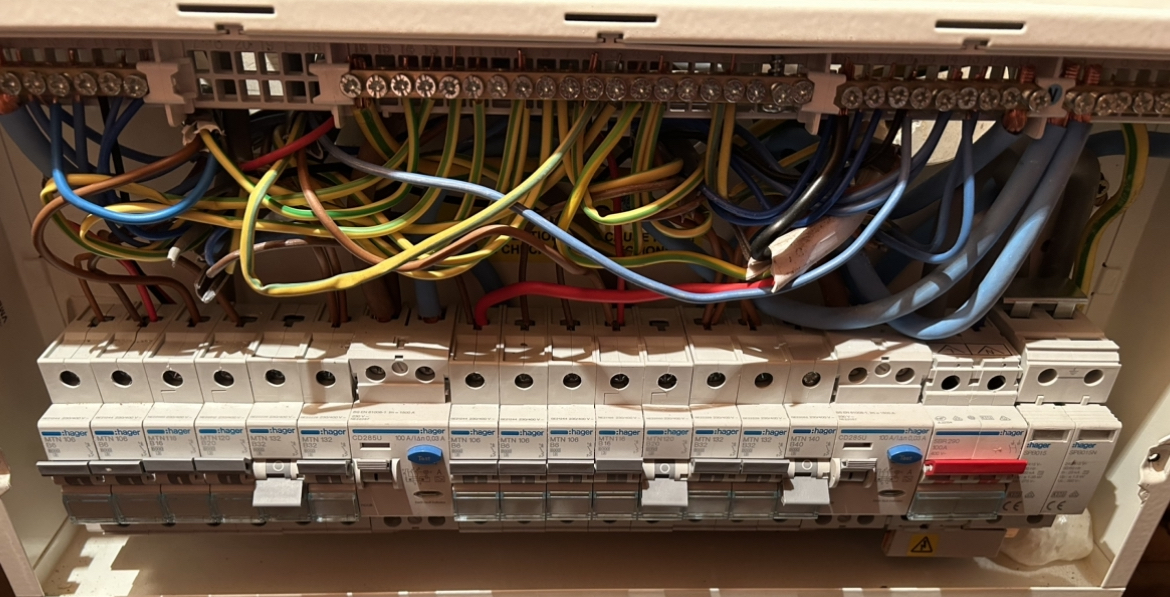

Didn't you say there was no testing carried out? And no certificate? That is a fail straight away.
Out of interest is this how you leave them ? Would you put your name to it ?
Fair question to my post i suppose. The answer is definitely NO. I am one of the electricians that actually would not have given you an option lol I would offer full RCBO or decline to quote. But as my post was pointing out I am trying to 1. save you money and hassle, 2. what has been fitted is "fine" as long as you get the bits mentioned fixed.
If I were looking for a comparison and even this is a poor attempt by me lol I would say it is like owning a 1990 diesel with full mot as opposed to owning a 2023 diesel which has all the modern conveniences and EXTRA safety features. Both perfectly fine...but one is more fine than the other. (Like I say probably a rubbish comparison but I try to give it a go lol...)
Above that If anybody working with me left that mess then they would be revisiting until it was fixed (regarding the flaws on the install). And if they turned out work like that a 2nd or 3rd time...they would never make the 4rth.

Agreed. Id I were walking into this as the 2nd spark I'd want control as to what goes on. There must be someone on here that can help? That install needs testing and putting right.
The install is dog rubbish and an embarrassment to the trade.
Yes I was in the house, literally a few meters away, the board was up and wired within 60 or so mins. To Identify the circuits he sent the apprentice, he turned it on, and checked which lights/sockets went on.
There was no testing, for example when you hear the RCD tripping multiple times, there was no megger or equivalent. He went around with a socket tester (the £20 one's - i've got the exact same one) - where they identified, one of the sockets was wired in reverse. As we speak, in my lounge, I have wall lights, and two sep, ceiling lights. I can't have all three on. When I flick the switch, it turns the wall lights off and the light on.
I've asked him for the readings like Zs, Zr, and he isn't providing them. No certificate has been issued. He is refusing to issue one, until he gets full payment.

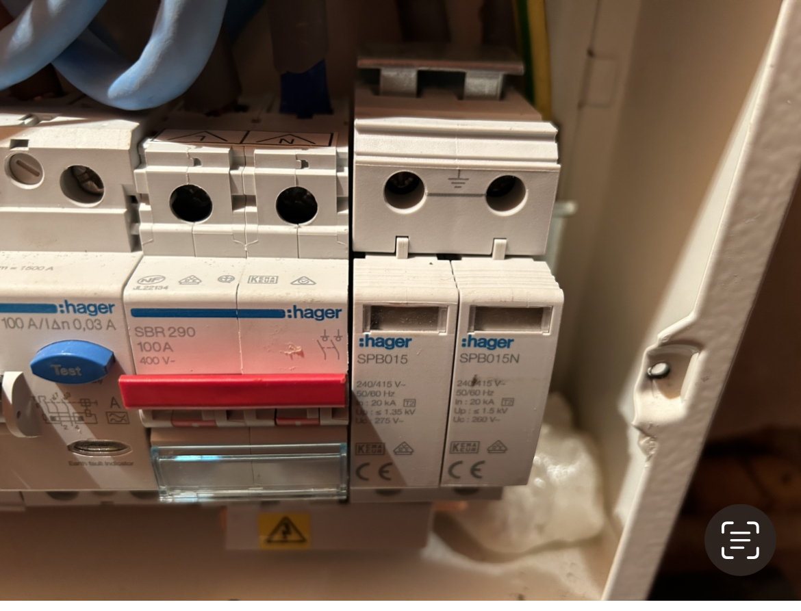

@timhoward , @Debrahim , and anyone else who may be interested. Hager helpfully got back to me today about the SPD query:
Good Morning
The surge gets its earth from a clip that bites onto the din rail and then its all earthed up via metal enclosure,
Regards Jim
So good news, it is installed correctly.

Thank you diddy, so do you agree that the board is a mess, and below what one would expect from an electrician ?
What bad workmanship, tell him get sorted or I will get another person in to sort it and what ever cost will come off your invoice.
Indeed, but more worryingly it hasn't been tested. He has tried taking advantage of my mum, knowing that she is elderly and doesn't want the stress etc, into thinking his work is acceptable and that we should pay up.
In his view that board is done and completed, and the balance is due. I've told him i'm not paying, from my reading it definitely doesn't meet regs when I can stick my finger in where the tails come in, and also nothing supporting holding the tails. When I pointed this out it he used some spray foam in it, saying they will support the tails?
As others have said, red and black hasn't been used for new installations since 2007.

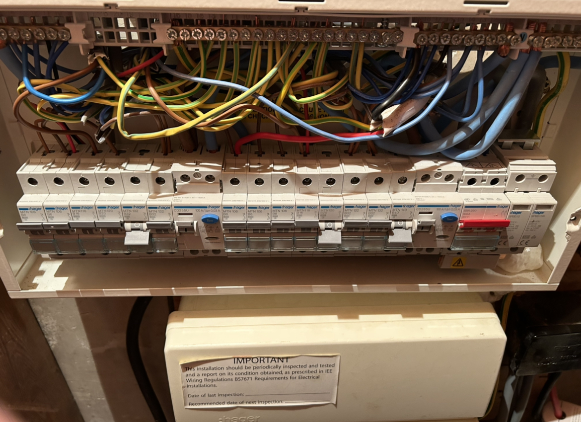

If it was a rewire, then carpets up, boards up, decorating after. Different than just changing the board.
If it was a full rewire, id be checking more than just the board....
Come to think of it.... why is the cover off?
Yes, had to empty the house to the lock up, walls all chased. Flooring opened/cut open.
Had the place re plastered and decorated.
He left the cover off while he went to his van or loo or something like that. I didn't remove the cover for the purpose of that picture.
