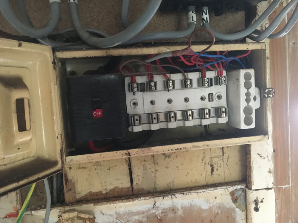

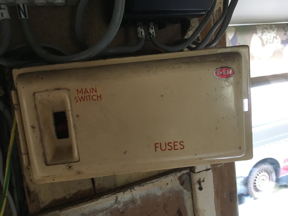

Stripping this out today. @Lucien Nunes you want it?
no asbestos in the fuse carriers. And that’s VIR tails supplying it.
Reactions: Dave OCD
I can only see room for 6 Tel ?? :-)
Reactions: loz2754
yeh. sorry, theres no cartridge fuses. all rewirables.... The neutral bar is hidden behind that spare cartridge fuse holder.
Got all 6 fuses and carriers.
All the earths were taken back out the 3/4 holes (wouldnt be 20mm in them days) unsleeved, twisted together and wrapped round a bolt through the casing.
