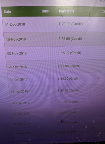

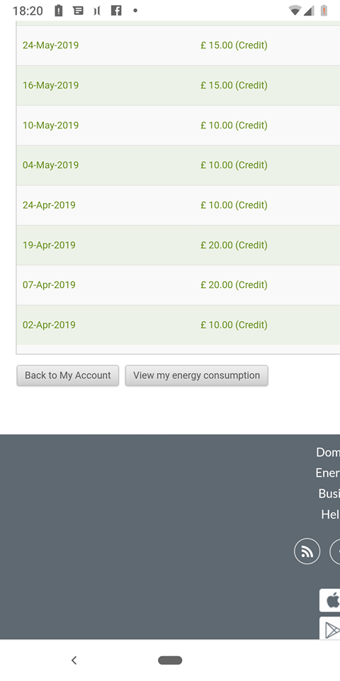

Hi thanks for the reply yes its a pre payment meter
24-May-2019 £ 15.00 (Credit) £ 1451.10 in Credit
16-May-2019 £ 15.00 (Credit) £ 1436.10 in Credit
10-May-2019 £ 10.00 (Credit) £ 1421.10 in Credit
04-May-2019 £ 10.00 (Credit) £ 1411.10 in Credit
24-Apr-2019 £ 10.00 (Credit) £ 1401.10 in Credit
19-Apr-2019 £ 20.00 (Credit) £ 1391.10 in Credit
07-Apr-2019 £ 20.00 (Credit) £ 1371.10 in Credit
02-Apr-2019 £ 10.00 (Credit) £ 1351.10 in Credit
21-Mar-2019 £ 20.00 (Credit) £ 1341.10 in Credit
14-Mar-2019 £ 10.00 (Credit) £ 1321.10 in Credit
Here are my topups with Scottish Power i gave them my readings on Friday they didnt bill me for 2 years
I looked at one of my bills in 2015 this was a actual reading bill which left me with £450 in credit i forgot about it since
And now I'm trying again to sort this out at my credit is going so fast on the meter
Gas is £600 for the year water is heated via gas I cant think of anything mayor Thats costing so much

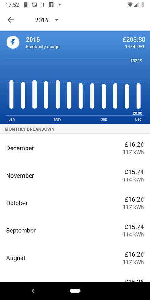

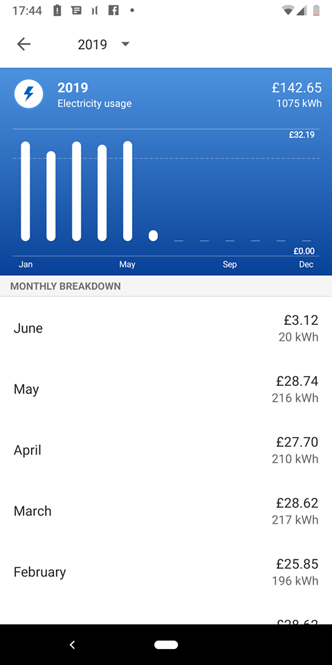

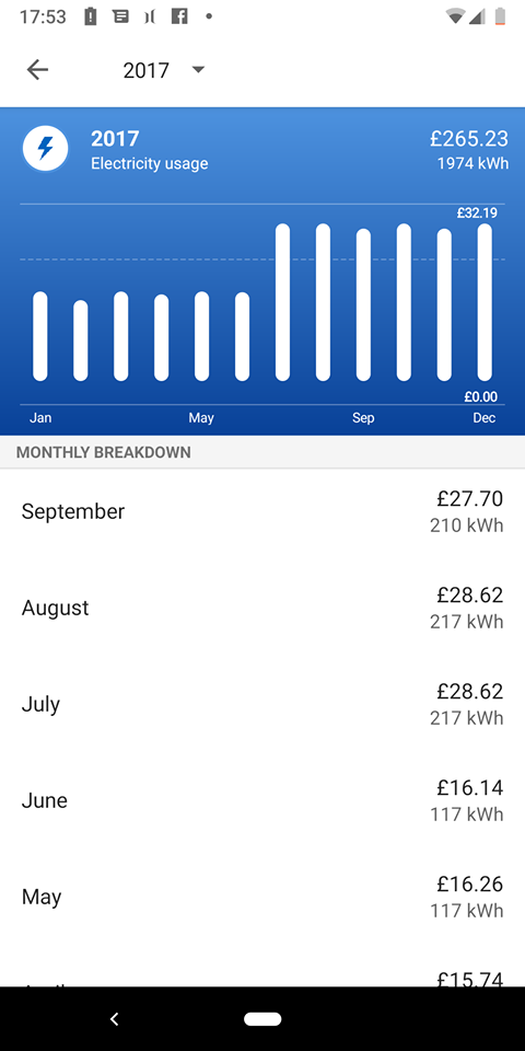

I downloaded the scottish power App and the bill for 2018 it says £366
And the topup payments doesn't match the
monthly breakdowns
Here is up to date 2019 kwh usage
as you can see the topups dont match up with how much it costs
They have gave me a bill for £ 885.47 which was for the 2 years leaving £ 565.63 in Credit I asked them to go all the way back to 2008 when i moved in here
As i cant go back to 2008 and only 2016 i have had the same sort of setup only difference is was a tv I can not see how much i have topped up
i will post grapths you can see the spike in rise of kwh First is 2016 which i bet i made more than £20 top up a month so it will be interesting to see
Scottish power said i will soon be able to check my top ups for that year
Does this make sense even on some of the letters sp saying 6600 khw for the year
I have even looked at some of my old estimated bill even one year in 2015 it says estimated bill for the year 13k khw lol
