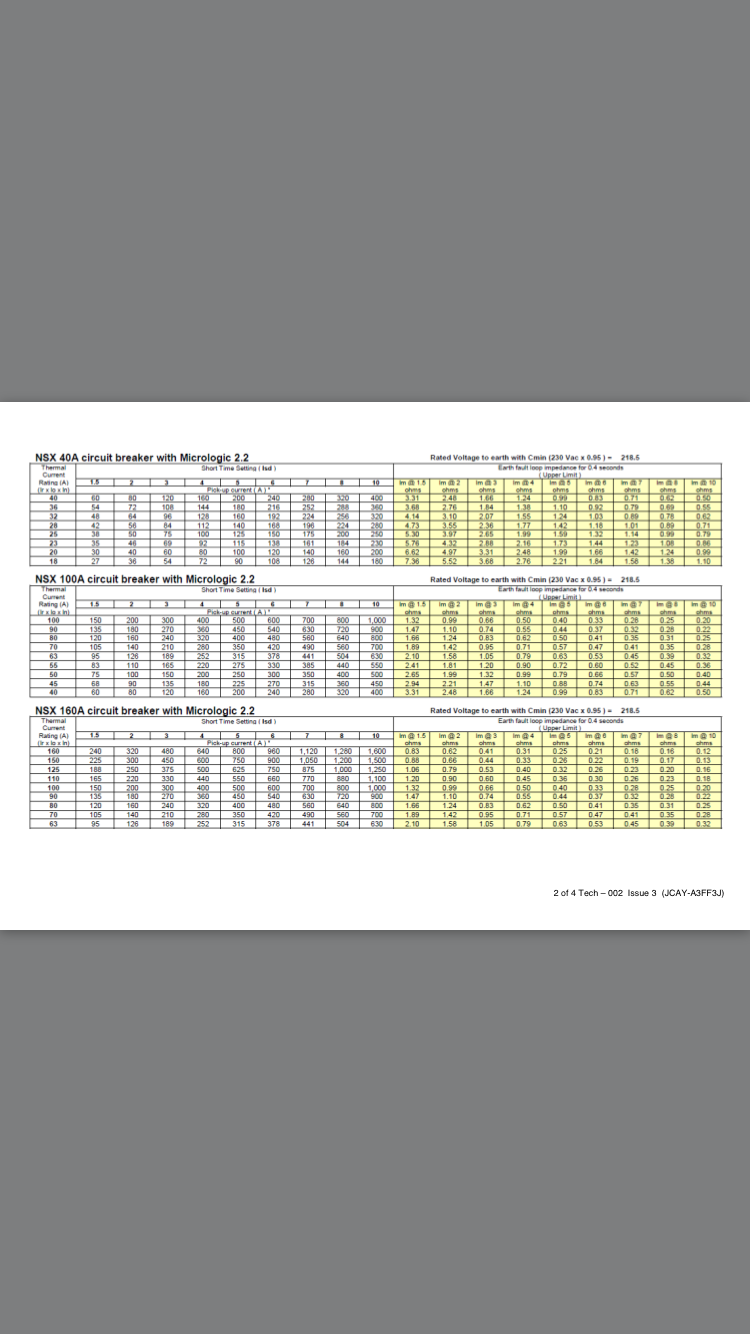

Just after a bit of advice from thoose of you that deal with this regularly & want to make sure i get it right.
Swa submain to phone network mast
63Amp single phase supply
Pme supply assumed ze of 0.35
245M run
Ive been trying to calculate which size swa & cpc or 3c swa to go for, would like any experienced input.

Without knowing Ze your a little stuffed...If there is no way of knowing then I would be looking at pricing to install a MCCB with adjustable earth leakage/fault protection.

Very rough calculation whilst sat on my sun lounger next to the pool.....If the earth leakage relay was set to o.8xIn then 50V/50A=1 Ohm
Gives you a bit of room to play with if your taking Ze at 0.35 Ohms.
If your calculations are using 63A as Iz then i recon your looking at using around 150mm based on volt drop.

Can you get an earth leakage trip with a 50A tripping current? I've never yet seen them go above 10A
What are you basing your VD calculation on?
My rough calculations based on voltage drop come out at 2x50mm in parallel, based on a mobile phone mast not including any lighting requirements and not having any specified voltage limits stricter than 6%

I got the mV/A/m figure from a manufacturers data sheet. Good point about to 50A setting....I just assumed they did. I've fitted one with a 30A max setting before.
Thanks for replies.. some good input from respected members.
Its the max disconnection time & VD that are the main influences over this length.
I was looking at putting a kmf or switch fuse between dno and metering with a bs88 gG 63amp fuse in, @ 80% value gives me a max zs of 0.62.
Using 95mm 2c swa & 35mm cpc gives me a max Zs of 0.56 assuming 0.35 @ dno.
Using the 95mm gives me a VD of 9.5v which is less than the 5% (11.5v) i need to be under.
Any thoughts on this method?
