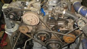

HI ,
Thx for the reply..
I would like to mount alternator like below pic.
Might be a better idea to fit a single,up-rated alternator,and associated split charge/current limit devices.
...Let's not give a Landrover ONE more mechanical piece to fail...:icon12:
