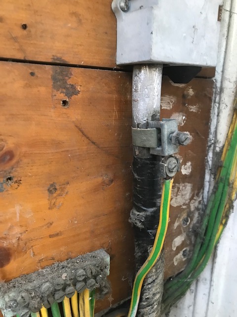

Im currently in a dispute with UK power networks about who is responsible for the incoming earth? Now, i know under normal circumstances the owner has to take responsibility for the external earth, if an earth has never been provided via the normal channels (TNS, TNSC).
This particular installation is, what i believe to be a TNS. Based in urban north London.
Ive had fluctuating readings from 1.4ohms to 80 ohms. Now i can't seem to get this down any more than 20 odd ohms. The uk power network chap, couldn't even get a reading. (his tester looked old and beaten.)
UK power networks are disputing it ever being a TNS system because it doesn't have one of their connections on. The ribbon or whatever its called. Thats their main defence. For me, that doesn't prove they have never provided an earth. someone could have take off their soldered connection.
Does this not look like a traditional TNS but without the soldered earth???
is there evidence of a sweated connection on that lead sheath? what's there now looks DIY.

The lead above the clamp looks very clean and shiny! Was it cleaned for testing purposes?
Yes.
I tried to get a reading and re-instate the earth.
It was fluctuating all over the place.
1.4 was my lowest and then is shot back up.
It’s a clearly a break in the earth further down the line.

I suspect that the original connection to the sheath is under the black tape and is probably a relatively thin, by modern standards, uninsulated conductor.
I would guess that in more recent years someone has decided that the old connection is too small and has taken it upon themselves to fit a BS951 clamp to the sheath.
You may be able to find the original connection under the tape, but you'll probably find that getting UKPN to fix this relies more on getting the right person on site rather than proving what/where the original connection was.

2" below that clamp appears to be bulging under the tape. bet there's a sweated bare earthing conductor there that's been cut off.

These are PILC cables (Paper insulated lead cable). The outer protection (Armour) is made from lead, an normal practice is to solder to this. PILC cables are old, some as old as our distribution network being DC!
They are bomb proof and will easily out live the person installing them. However the shear cost of production stopped them from being used.
In response to the OP. As @telectrix mentioned looks like something could be there a couple of inches under the jubilee clamp. Hard to tell if it is a bulge or dirt and camera angle.

The problem here is more one of the rules than an electrical one. The OP knows there is a fault outside in the DNO / PoCo's service cable or a joint in that cable because it's not providing a satisfactory earth connection. However, since the connection at the cable termination is of the wrong type and damaging the cable, the DNO will say the connection is not original which means they are not obliged to maintain it, so they will remove it and not fix the fault outside, leaving the OP reliant on a rod.
If the OP can find clear evidence that the original cable was soldered to the lead sheath, it will force the DNO both to reterminate that and to fix the joint outside, at no cost to the customer. The regulation that Westward10 quotes is useful, as it might force the DNO to address the high resistance joint even if they don't think it's their duty to provide the customer with an earth. Then, the OP could potentially use it by fitting the correct type of clamp.
