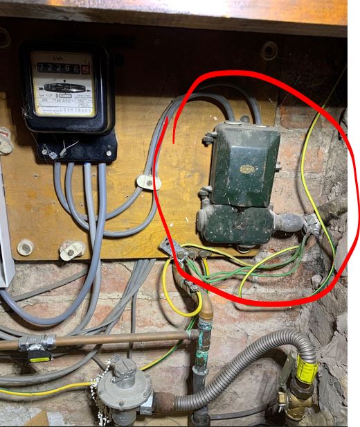

I completed an EICR at a customer home in the week and came across this old Crabtree DNO equipment in the meter cupboard. Just two questions really
1. Does anyone know what the BS number of this equipment is (See pictures)
2. Will the DNO replace it if the customer requests an isolator switch fitted? (I'm quoting the customer on a new CCU) I ask because I've heard these old incoming DNO supply enclosures are not to be messed with, at all.
Thank you in advance

Wouldn't the BS number be for the fuse inside it rather than the enclosure itself? Would guess 1361 (now BS88-3) but you'd have to open it to look at the fuse. It's a fine looking antique isn't it?

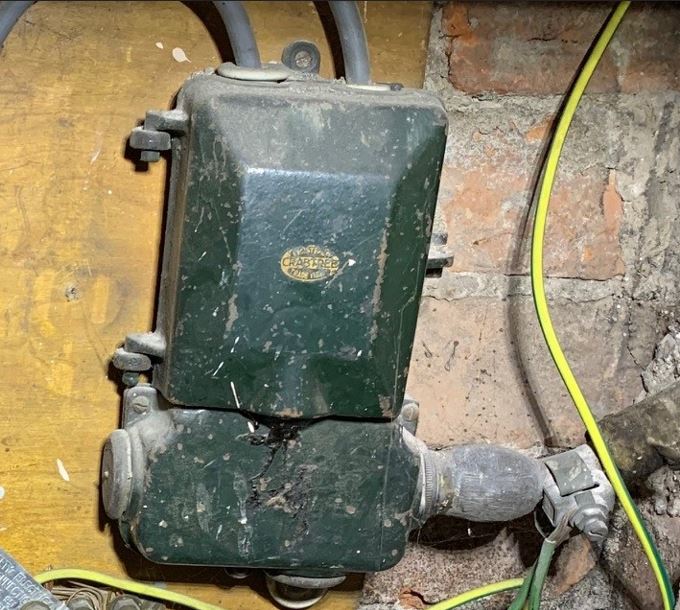

Under no circumstances open it. It may well predate a British Standard and there is every chance it contains BS3036 semi-enclosed fuses, when I say fuses it may well have one through the neutral. It will almost certainly be replaced.
Is it wrong that I really want to see what's inside it? Could it really be 3036 fuse wire? Maybe a lovely bit of asbestos? Could there be a fused neutral? I find old gear fascinating.
Those tails coming out of it look like PVC so they've been updated at some point.
I know, that's why the DNO guys have those heat jackets, gloves and the face shields in case the whole thing falls apart. Just curious, that's all :)
I asked because I have no intention of opening it regardless of curiosity... just wondered if you'd come across them before. Also, there's tar leaking from the enclosure so I've requested the house holder contact their DNO to get it assessed ASAP.
Can't see it being anything other than 3036 with fused neutral, although tails replaced (within the last 40 or 50 years).
Definitely a case for DNO. They will change it and renew the main earth connection. Better be quick though, before it topples off the wall.😉
Better off if you contact DNO and explain the situation fully.

Just noted your request to contact the DNO. It's already underway and the landlord has been asked to advise them of the leaking tar from the enclosure. This installation has all kinds of Gremlins, but I suspect the issues stem from the various/random alterations done over time. Thanks again
Predating BS88 is a challenge, just the low number tells you something about the age of the fuse standard!
From memory it is something like 1921 it came out, so possible it predates it but you know what curiosity did to the cat.
Very likely. Certainly a "do not touch under any circumstances" item!

True. Even BS1361 dates to about the time we started using PVC cables in the late 50s/early 60s. There's still a slim chance that the cutout is not quite as old as it appears and there's a cartridge fuse in there.
I don't believe that meter is contemporary with the cutout either and if the cutout is as old and dangerous as feared, how would it have not been upgraded at the same time as the meter since they would have had to isolate it?

Exactly like one I had Western power out to.
It was fuse wire through both line nd neutral. it took 3 guys in 3 western power vans to discuss and desided to remove.
forst guy said it was fine, I disagreed pointing out the fuse wire to neutral. then his supervisor came out then a more experienced engineer came and did it.
