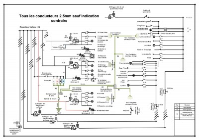

Hello, I am building my own house, and doing the electrical work too, but before I seal the walls and forget what my wiring looked like I want to make a wiring plan, but a detailed one so that in a few years time anyone living here can open them and know exactly where the wires are in each wall, how high from the ground they are and all that. I cannot find a software that allows you to do that, most of them have simplified wiring, and aren't really that useful. Any tips?

If you are building your own house then I presume someone has drawn the house up on a package?
What are they using?
Can they send you a PDF or dwg file of the house that you can use?
Have you had a look at Visio for a basic package?
Have a look at this thread. See if it helps.

take pictures, lots of pictures.
at every stage of the build.
keep them in a file for referring to in the future.
its not always a wire you are wanting to avoid, it can be a piece of timber that you want to screw into etc.

Visio seems like it is what I am looking for, doesn't seem too complicated, I tried AutoCAD, but I cannot master it fast enough right now.
And no, I don't have any electronic drawings, the house was designed many years ago and all of the drawings are on paper.
copy the drawings and then use coloured sharpies to draw the wiring in.
Many of the wires will be in "safe zones" which hopefully will dramatically reduce the need to copy onto a drawing. You can always remove a fitting to see if the cables go north or south, east or west if you forget in the future.

Visio are offering a 30day free trial at the moment with the added option of an electrical diagram software, its very easy to use as its drag and drop.
