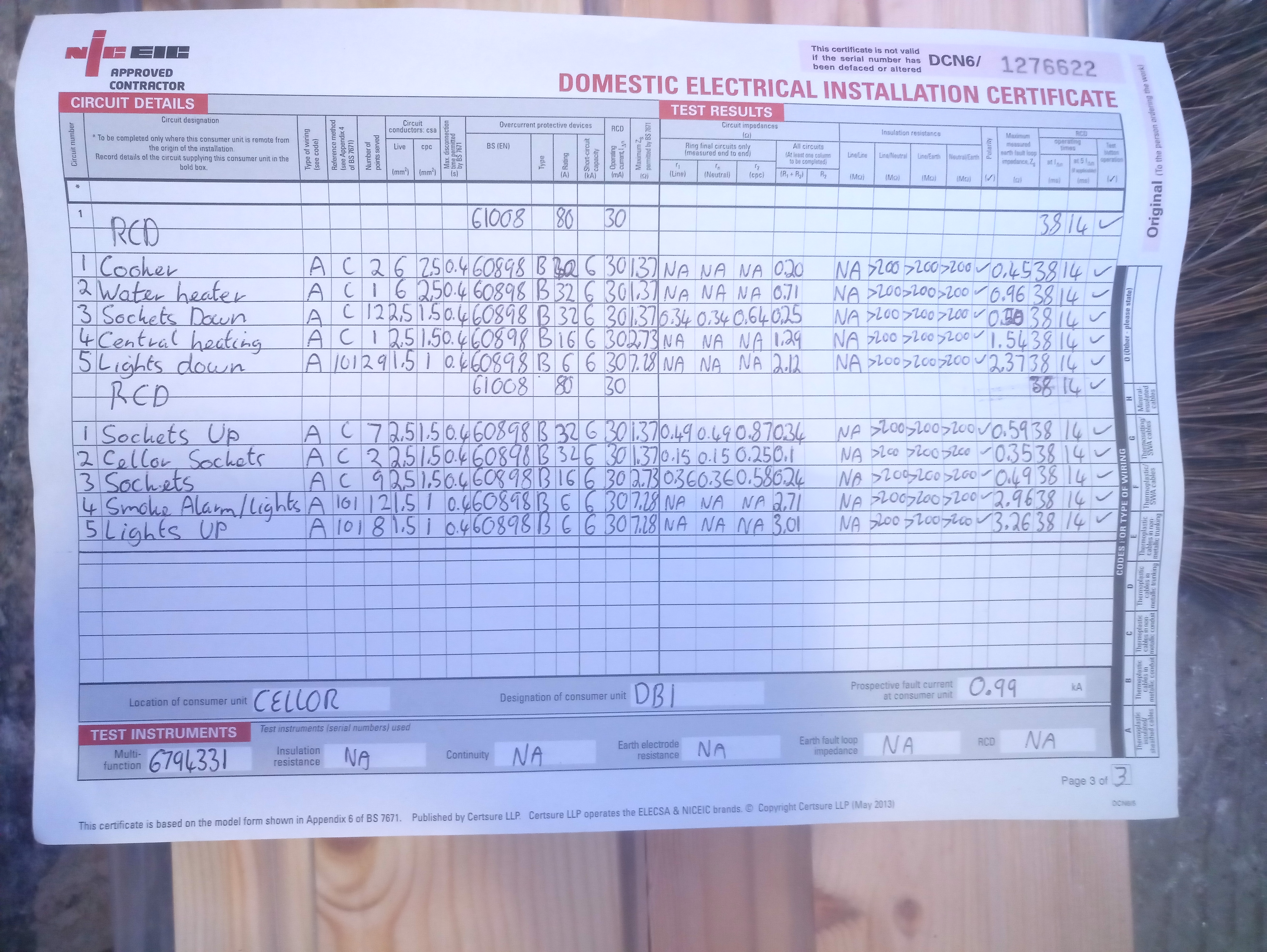

Little update, I got family member who knows a little on electrics to come give a view on it whilst I'm waiting and he has tried the following:
Next thing he did was swop upstairs 6amp breaker to downstairs and see if upstairs trips to eliminate faulty breaker. The lights this time stayed on for 1hr 40 mins before I decided to switch them off and go home.
Returned this morning to find the trip had switched for ground floor, so this has definitely eliminated a faulty breaker which isn't the case.
He will check all switches for loose wiring today and maybe disconnect all led spotlights and just leave the two main central lights in each room wired up and then see if they trip, as he thinks if they don't trip then the problem may well be with the cheap transformers and may have to replace all transformers with maybe 5watt capacity to sufficiently supply the 3w led lights .
Only baffling thing is they can still trip whilst lights are off so somebody here mentioned it rules out the drivers .

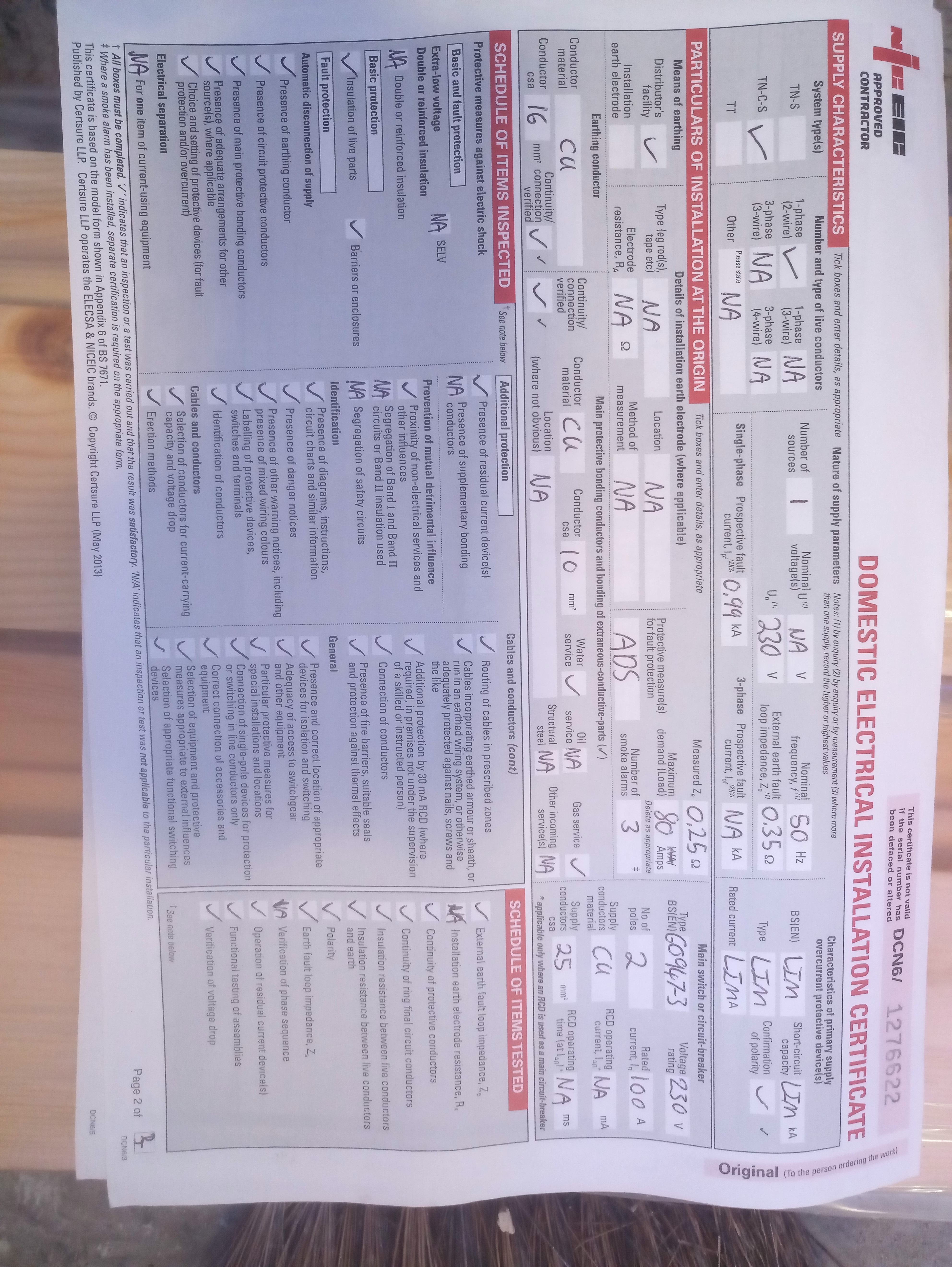

As for the installer whether he is NIC approved , the answer is I am not sure but is there a way to check online or somewhere , I know the tester is as he provided the certificate .

Ok ............. so this isn't an existing installation, its a complete rewire where a "sparky" has done the installation and a "tester" has done the testing. This for a start doesn't inspire confidence.
You need to stand firm and communicate with these individuals in writing ................. if they choose not to respond , I recommend you with hold any payments due AND also consider reporting them to local trading standards ..........
If may be prudent to ask around for another spark ......... sounds like you may need one and make sure that they are able to test and certificate - they can't issue a Part P certificate nor an EIC but they should be able to do some comparison readings with that EIC you have.
Out of interest have either of these individuals mentioned Part P?

I've not had much time over the Xmas and new year period to get much done and I will now check with EIC if the tester was registered as I believe the certificate number on the paperwork given should be logged online at some point.
