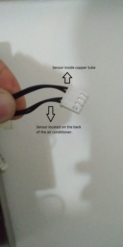

Sensor inside copper tube
That looks to be an acceptable reading. Can you make the sensor colder - dip it in some cold water - to see if its resistance decreased? And then make it warmer - perhaps hold it in your hand - to see if the resistance goes up.
Is that the only sensor?

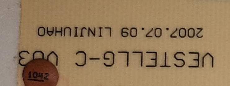

Could you tell me what is written under the white label on the large integrated circuit?
And also tell me what signal and sensor cables go to the main circuit board and from what. A labelled picture would be good.

VESTELLG - C V03
Sensor located on the back of the air conditioner (Picture 2). But I don't know what the sensor does. It says LR83355 on its cable.

You have two sensors as I thought. Please test the plastic one which is on the coil as well - you have your finger on its cable..
Reactions: dodo41
Gives 10.5 Resistor at 20K Resistance level.
Resistance -> temperature
Seems right again. Both sensors then seem to be fine.

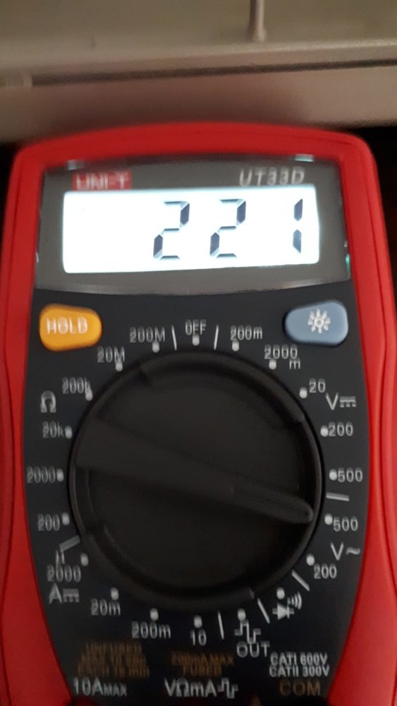

Please measure and tell me your mains ac voltage.
Reactions: dodo41 and DPG
I'm sorry for the late reply.
The voltage coming to the air conditioner outdoor unit is in the 1st picture.
The voltage coming to the air conditioner indoor unit is in the 2nd picture.
The voltage values you mentioned in turkaircon3 are 0-20V. I measured at dc level and Values:
V1: 12.57V
V2: 0V
V3: 0V
Reactions: marconi
dodo41:
So your mains supply voltage is normal for you at 220V - good; it is not low and good enough to power your air con.
