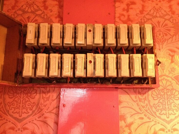

Came across this board today. "Home made" by the electrician who lived in the property in the mid '50s, fused neutrals, no main switch and all. The board was in as new condition and I don't think it has been worked on since it was installed. My photo probably does not do it justice
The current owner, a great lad in his late 80s, wanted me to connect up an immerser to his hwc, using the lead sheathed radial ( not sure why, but this appeared to be the only circuit not rewired in imperial T&E).
He totally understood why the board should be changed, but took the view "it's worked fine so far, and it can see me out"

When you say 'fused neutrals' do you mean fuses in neutrals only? I would have thought, looking at it that it was fused in line and neutral.

Joke, his efforts have stood the test of time.
Referring to the horror that some would feel seeing that.

I thought so ... I didn't want to step in with size 9s where angels fear to tread! I admire it! I am looking forward to discovering and, if at all practical, reinstating as many of the historic electrical features of our property that I can? We have some of the original bell cranks from the manually operated servants bell system. That was a delight when I stumbled across them in the loft! More interestingly and obvious, we have the turned wooden push switches in each room and central electrical bell unit in the kitchen; it was made by a local plumbing company, long since vanished. I am hoping one day to reinstate it as a working system! We also have what appears to be a wooden junction box in the loft which awaits some more investigation. Unfortunately I felt the need to remove all the GPO, lead headed and wrought iron nailed, cable clips from the outside of the house due to the risk of rust jacking and spalling of the stonework!
Fused line & neutral indeed.

Are you sure it's home made? It looks the spitting image of an MEM Katark fuseboard of that era.
I've come across a couple of them in my travels

Its nice to see the whole of the fuse holders intact,most like that I knew had some holders in 2 parts held together by the fuse wire
i went to an old wylex yesterday that the shower had melted the fuse and carrier in.
it would be fair to say it had a good old roast.
the wooden bit of the board?....... not a even a mark!
its becoming rare to find such beasts these days.i used to come across these quite often in my younger days as des says in various states of decrepitness.
That's NOT a homemade fuse box!! What you have there, is a typical fuse board from the early 40's and beyond (long before the 50's) and the type of board that the first all in one 3036 Wylex CU boards replaced after the 2nd world war....

he will mean fused line and neutrel, they were fused at intake for a long time if i remember right, lucien will be able to date it for you when they were fused
