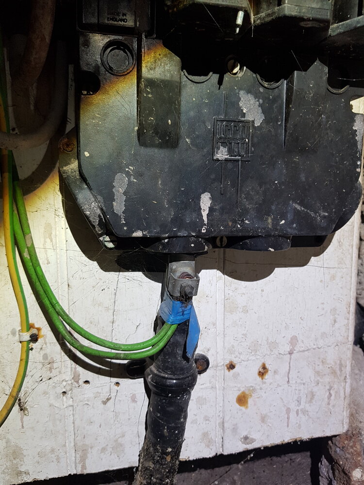

I conducted an EICR on a top floor flat but did not have access to the room which stored the meters and cutouts.
Previously my megger was not letting me obtain a Zs at the consumer unit and was saying 261V Ut >50v.

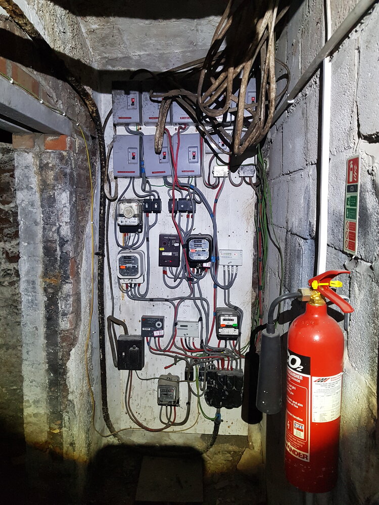

I have today gained access to the meter room and discovered there was no continuity between the earth in the switch fuse, and the Main Earthing Terminal for all the flats. This has been remedied with a 16mm earth. However, the meter room looks awful....
It looked like an earth went from top flat switch fuse to off peak switch fuse and then into another flats switch fuse and so on, but did not get back to the MET. Is it normal for the Main earth to meander between different flats switch fuses before a single cable goes from the last switch fuse to the MET? Should they not have a separate cable for each flat?

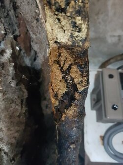

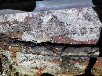

Also, the supply cable looks dire (see pictures), but I have not studied a new piece of this cable so am unsure what it should look like and whether the state it is in is dangerous?
Lastly, the TNS seems to have a bonding clamp rather than the usual joint I see on a TNS, this is not a proper TNS joint so would you be contacting the DNO for this?

The wires to that bond clamp are green, suggesting it is pre-1977 installation for that, though the meters seem to span many decades!
I guess other flats also had no earth continuity then? Wonder if other EICR just skipped that bit?
I have no idea what is considered proper for the earth route, but to me the first choice would be a large enough MET to take separate wires from each flat's switch-fuse. If impractical, I would at least run the CPC round as a ring back to the MET so there is a redundant path in case of a bad joint, etc.
Hopefully others here can provide more useful inputs.

Thanks for that PC. How about the condition of the supply cable, the outer sheathing/insulation is falling apart in places as seen in the pictures?
I do think that perhaps electricians sometimes skip taking the main earth out of the earth bar for the Ze, hence not getting a correct result and on occasion missing this type of fault.
I don't know enough about those cables really to comment, but I would try and forward a photo to the DNO (assuming they have a facility to receive it!) for this take on that matter. Same for the earth clamp, it is not looking that bad and could well be original, but it has a bit of a pipe-bond look to it.
The cable, I would say, is an old lead sheathed and, as a result, will be perfectly OK. The connection should really be renewed by the DNO...should be a soldered connection to the lead, although a constant pressure spring clip will suffice. (Hepworth)
edit. What type of clip is on at present?...can't tell from the photo.
One more thing, why was I getting 261V from the line to the disconnected main earth (which wasn't connected to earth)? There was no circuit, so it was just like connecting to a random piece of metal which didn't go anywhere.

What you see on the outside of the supply cable is the tar soaked jute serving on the outside of the cable cracking, it is an additional protective layer over the lead sheath. It's similar to seeing the PVC sheath of MICC damaged by sunlight, it's not pretty but it doesn't affect the cable.

It's hard to tell from the picture but I think that is one of the older type of clamos designed for connecting to the lead sheath of the cable. A side view would help.
All those green protective conductors leaving the room are likely to be the original bonding to each flat, at a guess it has probably been disconnected in your flat by whoever did the shoddy board change through a lack of checking/understating on their part.
As for linking all the switch fuses tigether with a single earth, yes this was acceptable and still is. Those older switch fuses and other switchgear/DBs had an earth terminal or bolt on the outside of the enclosure for this purpose.
That cable has a steel band under the outer covering and it's corroded.
If that location is in a cellar then it's most likely water has got into the cable outside and crept down the outer corroding the steel band as it goes.
The clamp looks to be the type the DNO would use and no-one else and also looks like it's on the lead not the steel

Yes there may be steel tape or wire armour, in there. These are mechanical protection for the cable which is additional to the cable rather than being an essential part of it.
The armour, whether it is tape or wire, does not form part of the protective conductor and the cable is electrically sound without it.
Whilst it is obviously degraded and far from in ideal condition the DNO won't do anything with it as it is still serviceable.

I am a little confused by the 261V, as the switchfuses were linked together it should have found a route to earth via the other installations.
This suggests that the CPCs of the submains are all cut off at the load end and have been replaced by the green protective conductors seen in your first picture. (I've seen this before where a 16mm T&E has its earth cut off and a seperate 10mm taped to the outside of it used instead)

2. The daisy-chain connection of the SF's to the MET might be acceptable, however it ought to meet the requirements of high-integrity CPC as it would be expected to carry significant leakage.
3. The clamp on the incomer lead looks like a constant-pressure type designed for the purpose and is probably correct.
4. The tarred jute serving is peeling off the cable but the STA looks OK inside, and the lead will be fine inside that. Nothing unusual to worry about as far as I can see.
