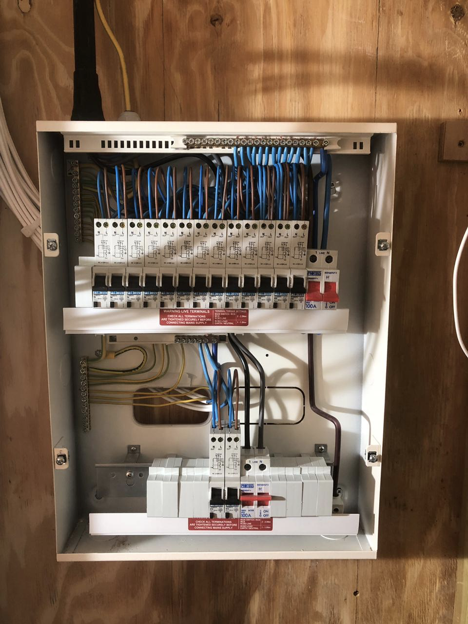

Hello, Please can I have some feedback on the quality of a fuse board I installed recently. I am fairly new to consumer unit installs. Newly qualified.
Have you used ferrules on your RCBO fly leads?
I'm presuming you only need to add ferrules if you shorten the lead, or do you guys add them anyway?
only thing i can fault is the bunch of cables coming in top left.some vertical plastic trunking would look better. otherwise a very neat job.
What is the deal on that big bunch of T+E exiting to the left? Have any applicable grouping factors been applied to the cables or is that not how they will be on the day? In an installation like this it is usually impossible to load them all heavily due to the limited total supply, but if some are run near their limit this can overcook them a little.
You've got nice long service loops on the L & N, not sure whether there is the same on the CPCs. I always like to make sure there are a few inches spare for re-termination by taking them across the board and back or around in a curve.
Can't see the armoured termination which is often a variable in an otherwise good install.
I know few people do this on a domestic install but I always number the cables with the appropriate DB way, to avoid frustration if multiple cables are taken out duing an EICR.
But yes, generally pretty smart.

Thanks for your reply I agree with what you are saying. I have previously uploaded a past board from this job and received the same feedback. My foreman is refusing to purchase ferrules does not think they are needed.
Nice job
Why is there a piece of cardboard wedged down the back of the consumer unit ? Packing to get level ?
