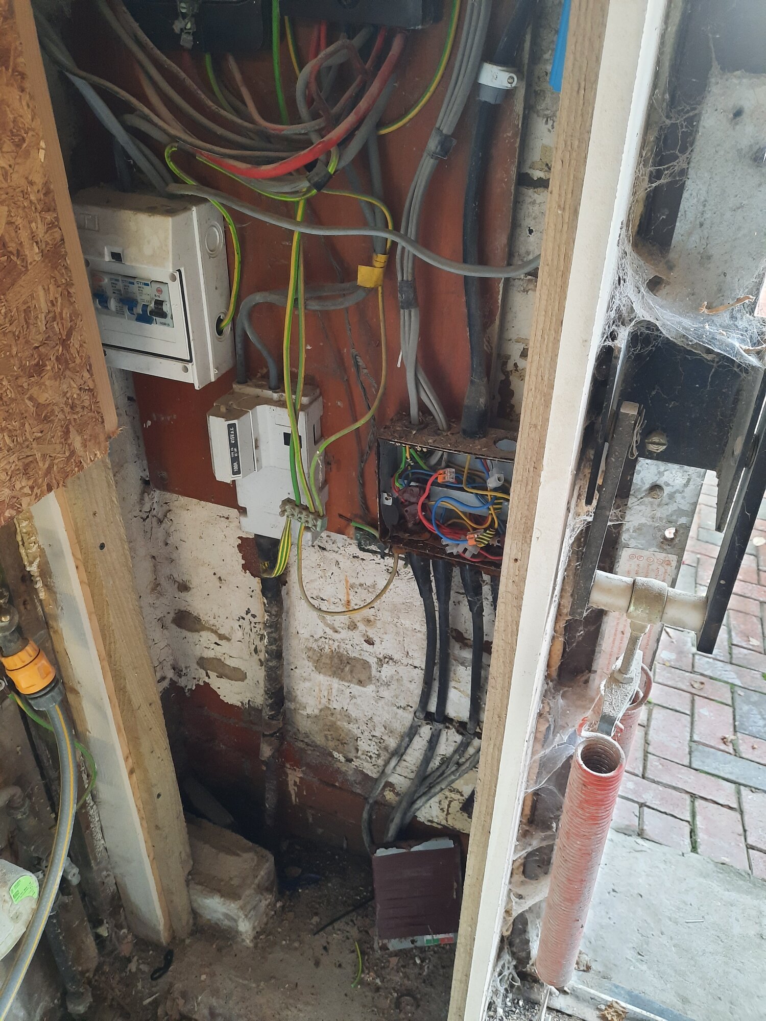

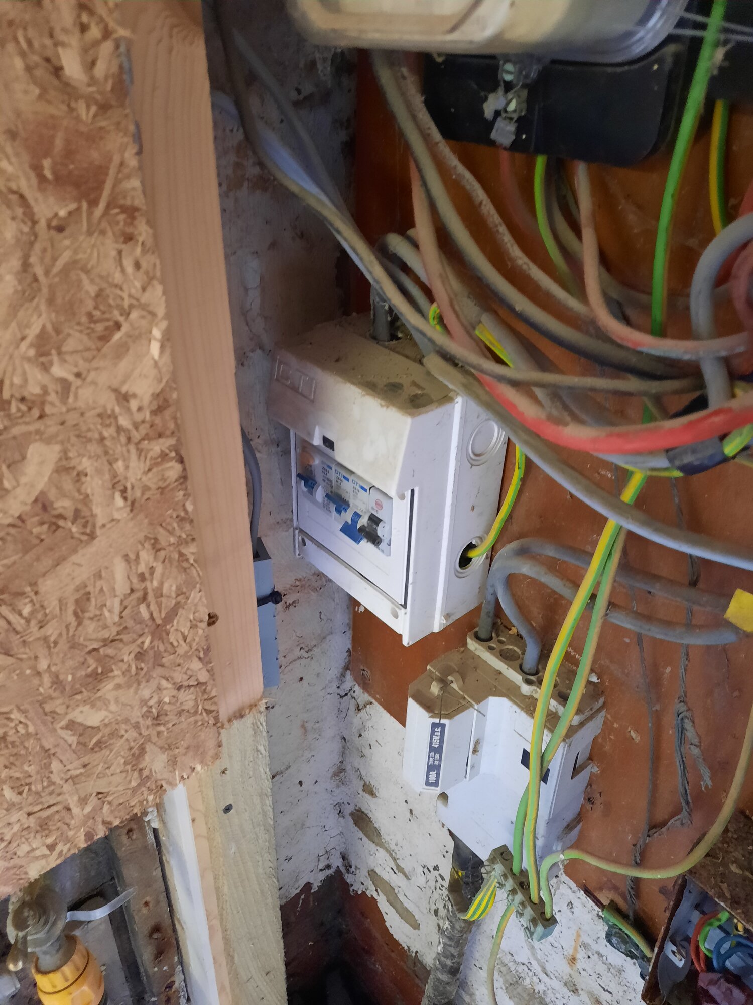

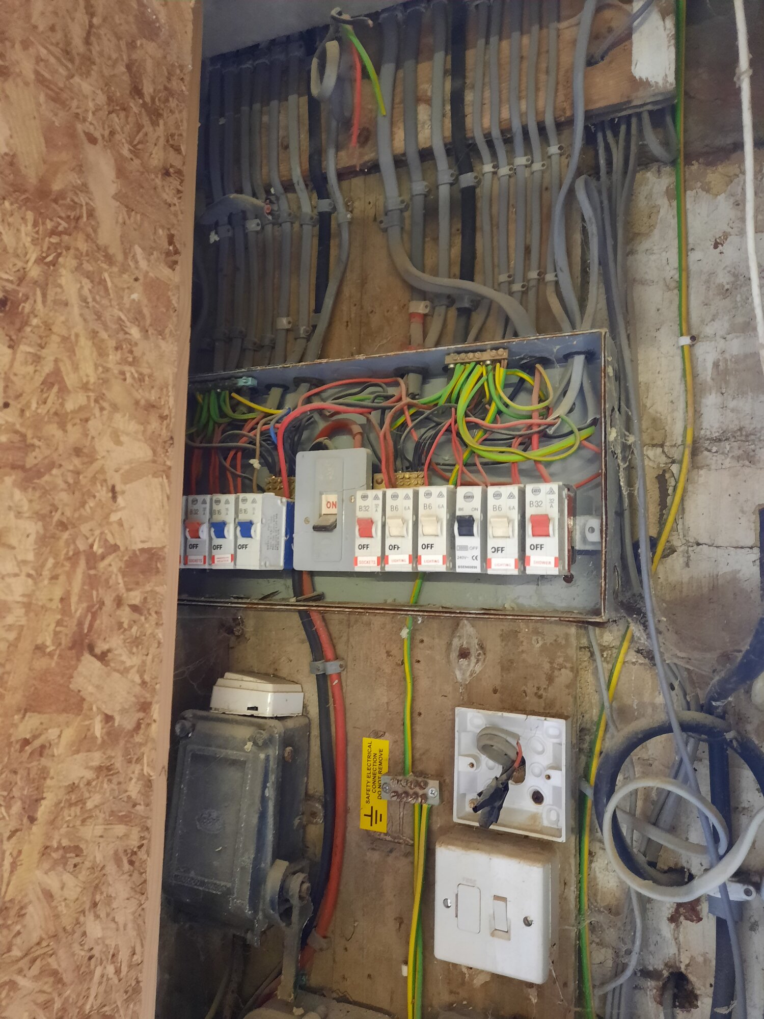

I have a friend that I do a few odds and ends for at his business, recently I put him in a security light and outside socket at home, whilst doing this I noticed the state of his CU(s)....
There are a lot of redundant SWAs an Isolator, tele switch that all need removing then all in use circuits consolidating into one new CU.
The customer is aware that testing will be required beforehand and remedials may be required before the CU upgrade.
He is sold on an all RCBO, surge protected board 12-16 way.

Oh dear, that looks like it started life as quite a neat job but has suffered over the years!
Agree , the original fuse box was neat with all cables clipped nicely and everything dressed in nicely
Looks like quite an easy board swap if alot of the later DIY additions can be ripped out
