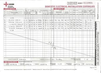

I like the way 'barriers and enclosures' is ticked but the busbar shield is missing.
The protective devices are listed as 60898 when in fact they are 61009.

How old is that Certificate as the schedule of test results doesn't seem to reflect all the inclusions suggested by the current version of BS7671.

Some of the test results look a bit made up, e.g. the Zs values for the radials - but made up by someone who doesn't know what they should look like. I also find Fusebox RCBOs all tend to have somewhat slower trip times than the results, but maybe your electrician had a particularly good batch!

Ze is apparently 0.61 but the Zs readings seem wrong when comparing to R1+R2.
As the certificate is a complete counterfeit I don't expect the content to be of any worth. As long as the job itself looks safe I'll move forward.

Even if the job looks safe, if the circuits were not actually tested, then they could be potentially dangerous. For example, unearthed metal class I light fittings, sockets with polarity errors or no earth, etc. You only find these things out when the testing is done properly.

Well that Certificate is not in line with the current version of BS7671 and whilst you don't have to follow this standard word for word I would expect the NICEIC to. So are you going to fill us in with the full story as in #1.
