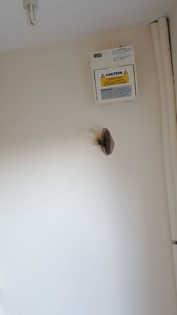

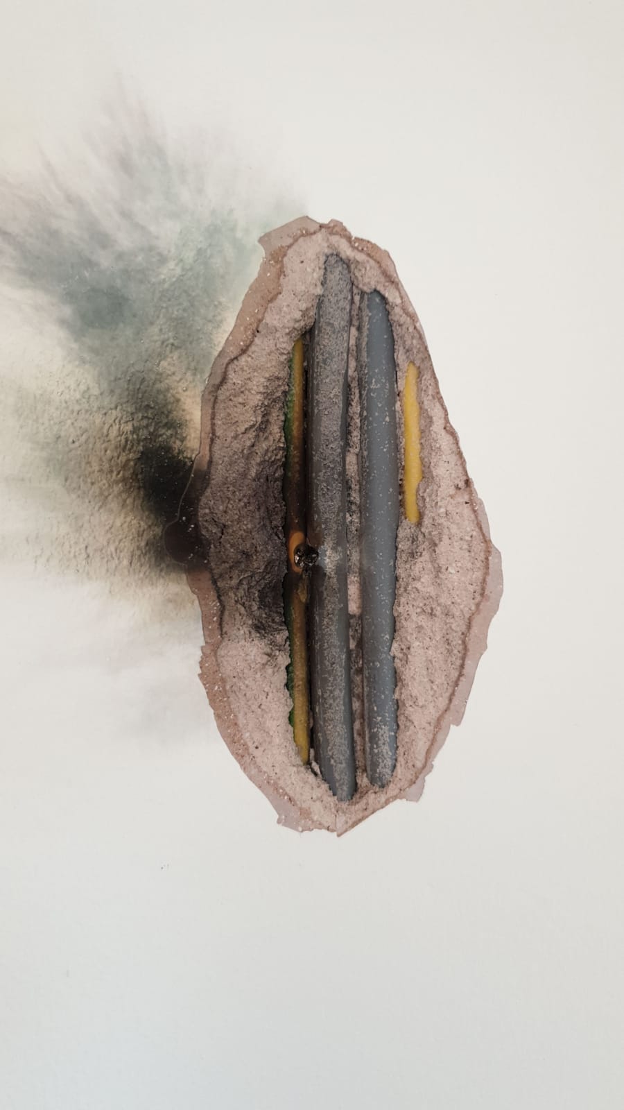

My son who has recently moved into a rented flat in Nottingham having got his first job there, decided to put up some coat hooks. He seems to have taken insufficient notice of the fact that the consumer unit is above where he was drilling. Apparently there was a very big bang and the hole shown in the picture appeared without any further exploration on his part.
He phoned me for advice and sent me the pictures, mentioning that none of the fuses seemed to have blown and everything is still working. I explained that the reason no breakers had tripped was that these are the main cables coming into his consumer unit and therefore before his breakers. I am a bit surprised that the company fuse didn't blow, but I guess it must have been a very short bang.

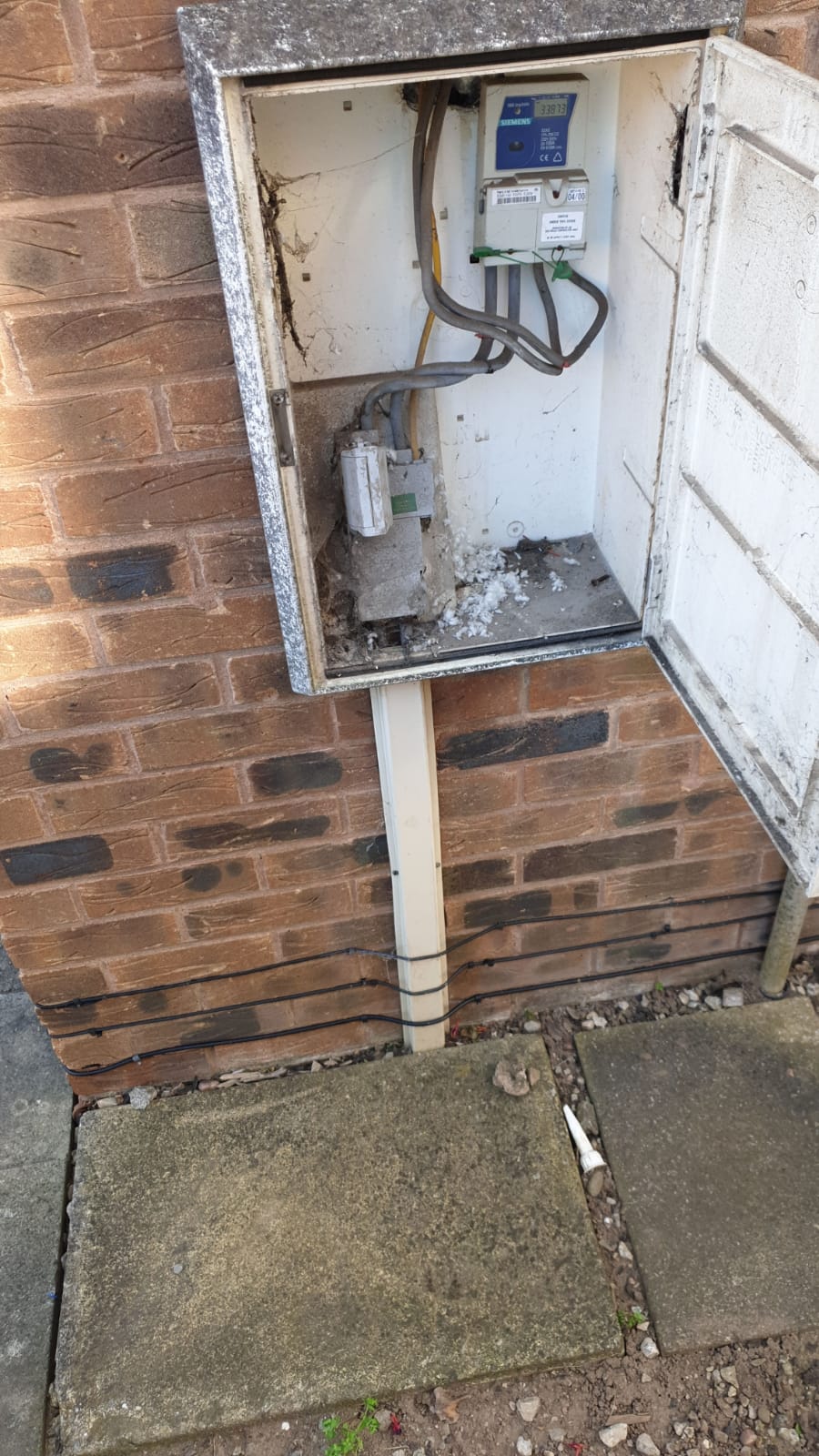

The consumer unit is near the ceiling on the opposite side of the wall to the meter cupboard.

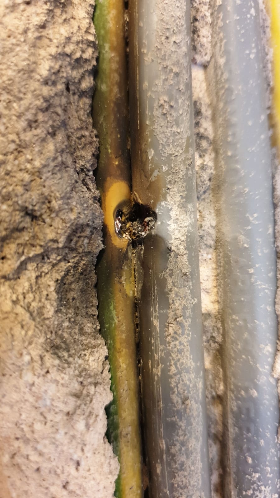

Those tails will need to be dug out and replaced. They will also need either RCD protection at the meter side or mechanical protection to prevent this from happening again.
Ideally the tails should be routed to negate the need for an RCD. It's going to cost him a few quid...
Send him this link: https://lmgtfy.com/?q=safe+zones+for+cables
There should be RCD protection on those tails as they're buried <50mm without mechanical protection.
The only way unfortunately would be to dig it out to inspect further and potentially replace...
Looking at it the left hand side earth cable (looks like a 10mm from picture) could be connected to the gas or water pipes, arcing could potentially bring the pipes up to 240v - would advise to get someone out to at least have a closer look.
You should not permit anyone to install an RCD on the supply side of the tails, it is likely your son will be plagued by nuisance tripping with total loss of power each time. This is would be a departure from Bs7671.The best option is to run new tails and earthing conductors in surface trunking which will remove the need for RCD protection on the supply side.
I would get someone out to replace the tails, however I am disappointed to see no capping over the cables to protect them from the plaster.
Be nice to see the damage in relation to the consumer unit.
Are they directly below? Is there any mechanical protection.
Hmmm, considering my son is an engineering graduate, it does look rather like he was trying for a Darwin Award.

It looks clear to me there is no mechanical protection.
The building is probably 1960s or 70s I don't know when the electrical instalation dates from. But if there should have been mechanical protection then that might help reduce his bill.

Not much wiggle room there to ne honest, other than mechanical protection, the cables are where you'd expect them to be.
Might be worth confiscating his DIY toys until he can prove hes not suicidal
Finally, is it appropriate for the main cables to be buried in the wall without any protection (from idiots).
Looking at the likely age of the installation I woukd say its likely that it was permitted for those cables to be buried like that with no further protection according to the regulations at the time.
However the current regulations do not permit this so the replacement cables will need to have mechanical protection installed. Whoever carries out the replacement will have to work to the current regulations so will need to Chad eout the wall to install the protection.

Will an electrician be able to do all the electrical work, or will they need to get the supply company in to connect to the meter?
