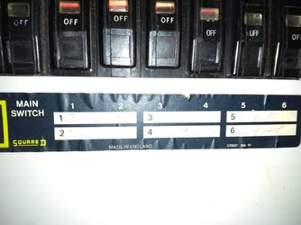

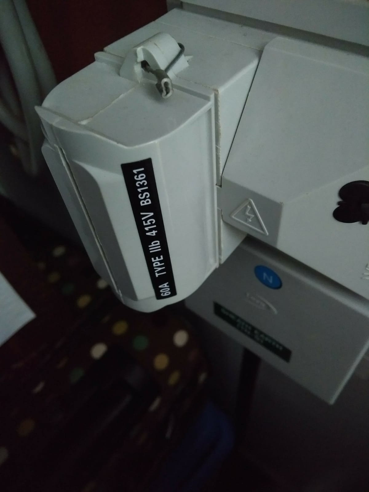

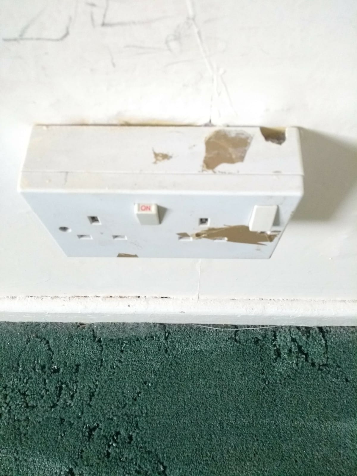

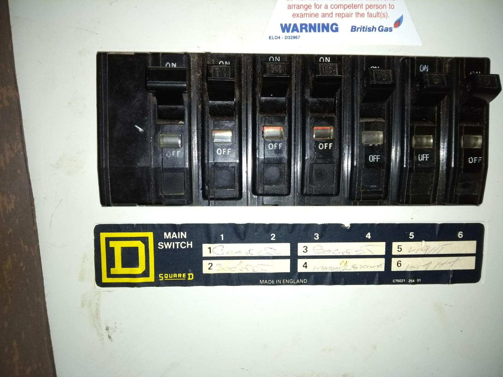

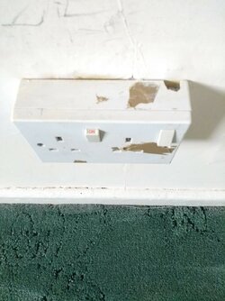

Please see attached photos.
When I called the electrician, he instantly found the problem. He then checked the fuse board which he said was in need of updating and conducted a basic visual check of other sockets and light switches. He was absolutely shocked by what he found and horrified they were not highlighted in the previous report.
I am wondering what was so horrifying?
£460 for a new fuse board is perfectly reasonable, I agree, but I have read elsewhere on here the following advice for not having RCD protection:
'Id have said c3...unless you wanted alterations but even then you could slap in an rcbo to protect the circuit you're altering.'
It would be good to get an idea of whether a fuse board was actually required or should have been a recommendation. Could an RCBO have been fitted based on the information the EICR contains?
Those are Type 4 circuit breakers which are not suitable for not only domestic but many installation types. It is doubtful although not impossible the higher rated devices such as 30A are not providing fault protection. I see from your Report he appears to have them as Type 2 assuming they are Roman numerals which is incorrect.

Looking at the schedule of test results again circuit 2 does not provide fault protection with a Type 4, 30A device. The schedule is incorrect indicating the person carrying out the test lacks suitable experience.

Experience I suppose. Square D QO-X mcbs if coloured brown are Type 4 and nothing else. Later white cased ones can be 1, 2, 3, B, or C and are never brown cased. The brown ones would have had it stamped on the front but nine times out of ten it has worn off.
