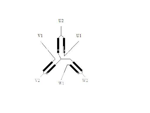

There are 3 contactors only in the panel , k1,k2 and k3. Looking at the 'working door' before removing the motor , when the door is selected down , only k2 comes in , when selected up k1 and k2 come in together. The motor is Electromaten SI4/8.85/165.35,00 which i now believe to be a two speed motor.The outgoing side of k3 has its three terminals all linked together. The door should operate upwards at full speed and downwards at a lower speed hence two contactors are in on the way up. Now i have simply replaced the motor onto the 6 original terminals and the motor goes downwards (close) regardless of wether i press in k1 or k2. if i press k1 and k3 (up) then the motor buzzers as if it is stalling. I cannot see what is wrong now the motor has been replaced (knowing it is a good motor).

What do you measure between U2 and W2? 18 ohms?

http://www.wiringmanual.com/motor052.html
- start with this info.
Low speed = supply via K2 to U1, V1 and W1 with UVW2 open.
High speed = supply via K1 to U2, V2 and W2 with UVW1 shorted or starred in K3.

On the original motor the direction didn't change. This time its doing the same but in the other direction. Try interchanging UVW1 with UVW2 and also two wires to the up side of the motor in order to change DoR.

Definitely check the contact continuity of each of the contactors K1 and K2!
It can't be connected correctly.
It sounds as if you need to swop over two of the conductors connected to one of the up contactors.
You say that when you press in K1 and K3 together, the motor just buzzes.
This would suggest that one contactor is attempting to drive the motor in one direction, and the other contactor in the other direction.
As both K1 and K2 drive the motor in the same direction, and when K1 and K3 are pressed together the motor buzzes, I would suggest swopping round the conductors connected to K1, so that when K1 is pressed the motor direction is reversed.
I don't understand why when up is selected K2 operates, to my mind it should be k1 and k3 together for up and K2 on it's own for down.
Did you have a look at the web site I posted? There are three ways of connecting these motors. If you are using reversing you need four contactors.
From experience I can tell you they are swine’s when they go wrong. We used them as reversing constant torque on a crane. Your using the variable torque connection.
This is why I asked if the control board could reverse a phase, as the OP said the motor supply comes off this board.
The other thought... as this motor turns one way in high speed (UP) and one way in low speed (DN) then can the motor be wired with lines interchanged on one side of windings?
