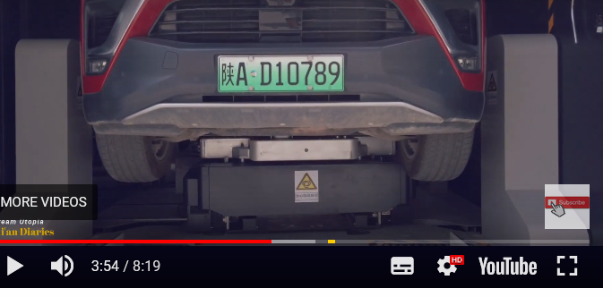

Hopefully once most cars on the road are EVs, we will have "petrol stations" in which you can swap out you battery pack in some way for an instant full charge, or a very very quick charger that takes a similar amount of time as filling with petrol
If she is going to have a driveway at some point then its a case of getting power from house to drive. if the garden is hers and the pathway comes with access rights. I would look into the potential to run a suitably buried SWA cable to the garden/future drive.
Don't hold your breath - unless they get orders of magnitude improvements in power density so that batteries get a lot lot smaller, they are always going to be packaged differently from one car to another as their shape and location is so dependent on the styling of the car, and vice-versa.
Again, watch you don't go blue in the face ?. A petrol/diesel pump is an approximately 35-40MW appliance. Pick any realistic figure you like for how much more efficient EVs are, even a small filling station is going to be a real challenge to replace with one that delivers electrical power at tank-filling rates.
indeed, just like the tesla battery being basically the floor and it would require all the manufacturer to work together, probably wont happen

I did not see them take anything out and put anything different in, just lifted the car and put something underneath it and then lowered it again, not very convincing IMO.
From 2009, ultimately the company went bankrupt but the logistics were there, unfortunately for them; that uptake from manufacturers wasn't.
