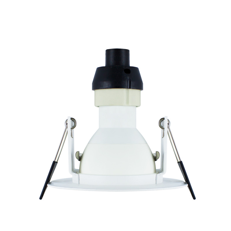

Doing an EICR today, in a multi occupied house, I was chatting to the landlord advising him to get fire rated downlights in the celar bedroom thinking the existing ones weren't such. I then showed him in the toolstation catalogue options for them - to come across one new fitting which doesn't look fire rated but is stated as such. This thus made me wonder whether the existing ones were indeed non fire rated...
Has anyone come across these kind from toolstation (cat no. 58865 https://www.toolstation.com/integral-led-evofire-ip65-fire-rated-downlight/p58865) and if so can you tell me if there is any distinguising feature that lets you know they are fire rated (other than a sticker, which I'm going to go back to check)?
If you pull the downlight out of the ceiling there will be a sticker/label on the fitting to say it's fire rated and any replacement should also be fire rated.
if it's fire rated it will have a seal round the back side of the bezel.

that fitting is fire rated glass ,why are you telling the land lord to change the fittings .
Cheers guys. I wasn't after any info on whether / how / when fire rated lights should be put in, and I didn't tell the landlord he had to replace them but rather while chatting and inspecting the downlights I told him it's advisable to have fire rated downlights in when people live above etc, I've never threatened or frightened a customer in my life and never will. I told him I wanted to investigate and get back to him. The point of my question was, having looked at the downlights they seemed to be of a non fire rated construction (and I couldn't see any obvious labels to indicate either way), but having seen the ones in my question which don't look fire rated either I began to wonder if there is a definative way of telling (other than a label). From what I gather (thanks teletex / anthonybrag) it is down to the glass and a seal. Alas neither of which tells you what fire rating the light is. So is it a case of if in doubt advise change - or - turn a blind eye? Incidentally I've noticed since several downlights elsewhere unlabelled.
In any event the landlord did is own research and spoke to 'his people' and has decided to replace them :cool:
Hi Captain - I only take the manufacturer's declaration as being reliable. Otherwise from me it's "Sorry, but I don't know what approvals these downlights have...". If I'm supplying downlights (that will be cut into the ceiling) they'll be fire rated :) .
