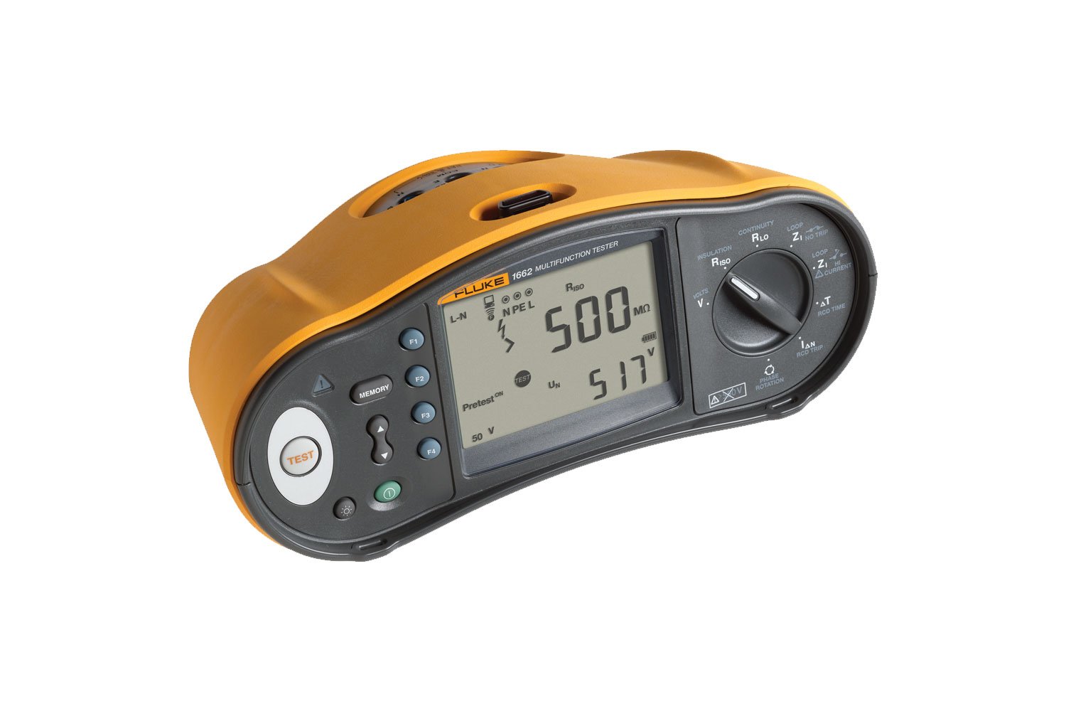

I don't know what is used in the USA but for something like a hot tub I would assume it should be a 10mA limit from a dedicated device, where as the common size in the UK is 30mA at the board as protection for general use (not high risk areas). A proper tester would allow the actual trip current to be verified.
This is a bit of a worry, and you really ought to get in a professional electrician who has such test equipment to be sure it is working as intended. In the UK a "multi function tester" that has that capability typically costs in the £500-£1k region so it would be much cheaper to get someone in!

Example of a MFT:
