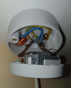

I'm looking for some advice for adding a time delay on my parent's shower room fan.
My parents had a section of their garage converted into a shower room with toilet. But the builders did something a bit odd. They fitted a pull cord light switch by the door and then a separate pull switch next to the shower to power the fan. Ideally the lights and fan should have been on the same switch. Unfortunately the exterior of the room in the garage has been fitted with boards so there isn't any easy way to access the wiring without either making a hole in the ceiling or removing the boards. My parents are keen not to make a mess of their new room.
They are frustrated that the fan does not have a time delay on it and wondered if there was an easy way to either replace the fan with a built in delay or replace the pull cord switch with a delayer inside.
I had a look inside the current switch and it is just a simple two wires with an earth. There is a separate fuse box for the shower power and lights/fan, so it was easy enough to turn off the power before I looked.
I managed to find one pull cord switch with a built in delay online but it was ÂŁ50, which seems quite a lot.
I can do the basics of electrical DIY if it's simply a matter of replacing one switch with another. Anything more than that and we would get an electrician to do it.
Obviously this is situation is not a huge problem but it just frustrates my mum that she has to remember to switch off the fan later.
Any advice gratefully received.

PIRs usually have a timer function. While in the shower it should stay on by sensing movement, then stay on after he leaves for the length of time it's set for.

You could also use one of these to do exactly what you suggested with a bit of work rewiring the switch and fan cables. When the switch is turned off the fan would keep running for between 1-45 minutes.
You have a neutral at the switch, a permanent live and switched live. The controller needs a neutral, perm live and switched live input, and the output is just live and neutral to the fan.
